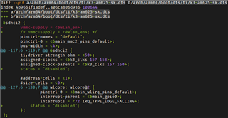

  • Hi Kylix,
    Please try to disable the sdhci2 node in the kernel device tree to see if this resolves the issue.
  • Hi Bin,
    After disabling all the sdhci2 node related to am62-serial in the kernel device tree, this issue still can't be resolved.
    The below are the modification for removing sdhci2:
