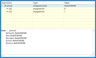

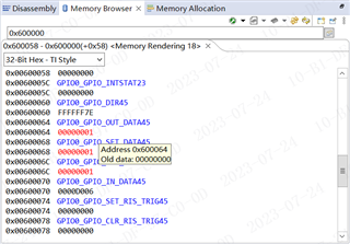

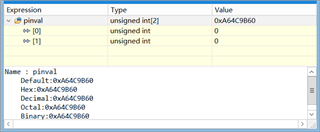

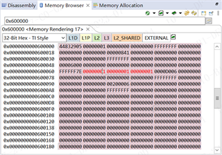

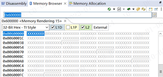

GPIO cannot be controlled on C66x DSP, and can be controlled successfully on R5 and C7x with the same code
Operation method:
1. Board: SK-TDA4VM, SDK version: ti-processor-sdk-rtos-j721e-evm-08_06_01_03
2. Using the PDK inside the SDK, add the GPIO test program on the basis of ipc_echo_test_freertos (modified from pdk_jacinto_08_06_01_03\packages\ti\drv\gpio\test\led_blink\src\main_led_blink.c), see attachment
 Board_initGPIO();
    GPIO_init();
    while(1)
        GPIO_toggle(USER_LED0);
        Osal_delay(500);
3. Modify pinmux, see attachment
        PIN_PRG0_PRU1_GPO1, PIN_MODE(7) | \
        ((PIN_PULL_DISABLE) & (~PIN_PULL_DIRECTION | ~PIN_INPUT_ENABLE))
4. Compile pdk_lib and ipc_echo_test_freertos to C66X respectively,
make -s pdk_libs BOARD=j721e_evm CORE=c66xdsp_1
make -s ipc_echo_test_freertos BOARD=j721e_evm CORE=c66xdsp_1
5. Use CCS to load the compiled product into the development board and run it
6. The LED on the development board cannot be turned on, and the LED corresponds to GPIO0_16 AD28
If compiled for C7x or R5F, the LED can be lit successfully
make -s pdk_libs BOARD=j721e_evm CORE=mcu1_0
make -s pdk_libs BOARD=j721e_evm CORE=c7x_1
make -s ipc_echo_test_freertos BOARD=j721e_evm CORE=mcu1_0
make -s ipc_echo_test_freertos BOARD=j721e_evm CORE=c7x_1
