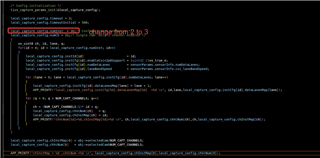

2) Due to the camera data being connected to CSI2-RX, I modified the single cam demo code ,
obj ->selectedCam=8;
local_capture_config.numInst = 3U

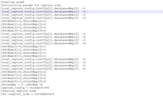

- The capture parameter code is as follows:
The parameter print log is as follows:
3) Detailed log as attached

  • Hi zheng,
    What is the value of selectedCam variable? This variable decides the instance to be used and also virtual channel. Like if the selectedCam is set to 0 to 3, it uses instance0 and virtual channel as 0 to 3. But it is set to 4 to 7, it uses instance1 and virtual channel as 0 to 3.
    Brijesh
  • HI Brijesh :
    As described above,
    Final implementation
    local_capture_config.chInstMap[0] = 2;
    local_capture_config.chVcNum[0] = 0;
    Is this configuration correct?

  • Hi zheng,
    The above parameters look correct. Could you please check and confirm

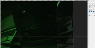

  • HI Brijesh :
    After resolving the sensor driver issue, the raw10 image can now be displayed, but it seems that there are the following issues
    1) The RAW10 screen also has screen cutout, and I suspect it is a problem with the resolution setting of the test demo,I will retest it .
    2) The image effect is not clear. I am using 7yuv for preview. Can you help me check if the settings are correct?
    3) Could you provide the ISP driver code for sensor OX03F10? Do you need me to resubmit new ticket  ?
    thank you !

       OK . Is my 7yuv setting is correct for preview raw10 image  ?
  • Hi zheng,
    I think 7yuv supports limited formats, i would recommend here to use IrfanViewer application. This application supports raw10 format.
    Brijesh
