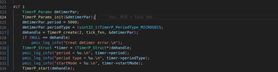

Hello Champs,
HW:own board
sdk:  ti-processor-sdk-rtos-j721e-evm-08_01_00_13
Customer is using DM timer on mcu1_0.
The period is 5000, period_type= 0
But the period exceeds 5ms, below is the log.
Shine

    #if 1
    TimerP_Params dmtimerPar;
    TimerP_Params_init(&dmtimerPar);
    dmtimerPar.period = 5000;
    dmtimerPar.periodType = (uint32_t)TimerP_PeriodType_MICROSECS;
    dmhandle = TimerP_create(TimerP_ANY, tick_fxn, &dmtimerPar);
    if (NULL == dmhandle)
    pmic_log_info("Creat dmtimer error.\n");
    TimerP_start(dmhandle);
    #endif

    1. Build the above code, the boot core is mcu1_0
    2 make u-boot-a72 DM to get tispl.bin (Please note that customer doesn't add his code to tick_fxn, TI engineer could use an IO as a test point on TDA4VM EVM, toggle the IO every 5ms)
    Above is customer's test result. The clock will hung after power on and it will not hung after linux kernel boot.
    Shine

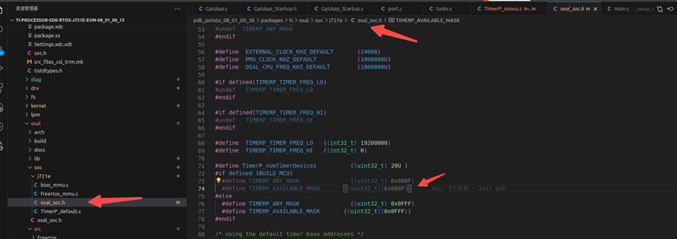

  • Hi Shine,
    The timer configuration looks fine.
    Do you see the same issue when just running the RTOS alone, without running the Linux on A72?
    Also, can you try using any other timer instance and see if the results are same?
    Parth
  • Hi Parth,
    Thank you very much.
    1. It works when ccs debug without linux.
    2. Customer has tried other DM timer, the result is the same during linux kernel.
    BTW, there are only few DM timer for mcu while there are many (about 20) DM timers mentioned in TRM.
    Customer also tried to modify the mask to 0xFF, but there are still some DM timers failed to create.
    Has TI experts tested the the DM timer based on tispl.bin successfully?
