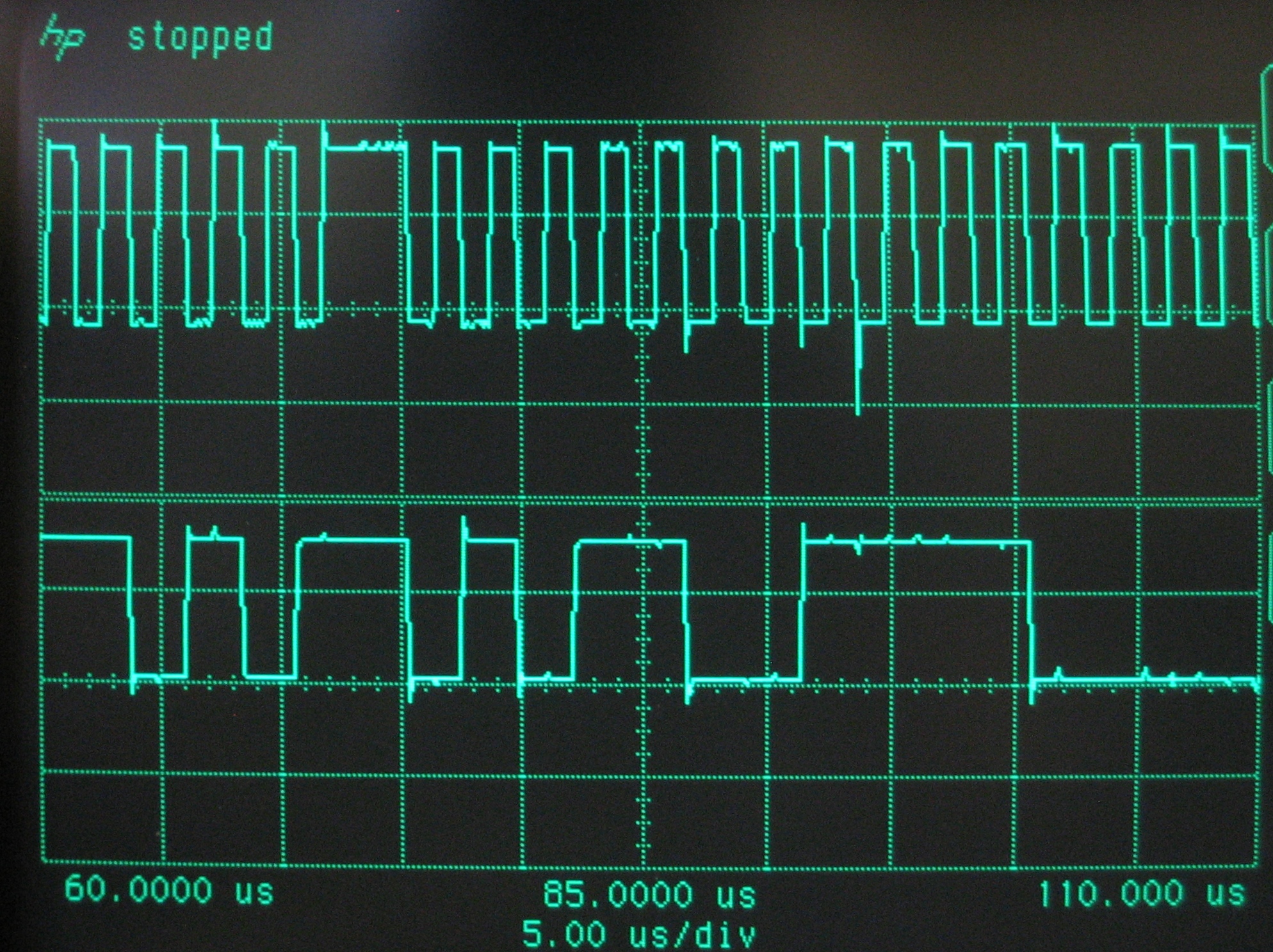

McBSP as SPI master timing problems
Whenever I transmit a burst of data (aka more than one word, such that the transmit buffers are both filled), I get a missing clock pulse in between words, which causes the data after the first word to be shifted.
Here is my initialization code:

and here is my transmission code:
    for(i = 0; i < 4; i++)
        while(MCBSP_FGET(SPCR1,XRDY) == 0);
        MCBSP_RSET(DXR1,data[i]);
I've attached an o-scope capture showing this effect. The data transmitted is 0xACF00F35 four times. The slave is sampling on the rising edge of the clock. Of note, the binary sequence at the boundary is 0101 1010, but notice how the missing clock pulse prevents the first bit from being sampled. How do I fix this?
