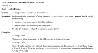

I am using TIDOFSimulator1.6.8b with the documentation TIDOFSimulatorUserGuide.pdf.
Among the simulator config parameters is --stepFrame, which I used.
However, I built the one in j721e-evm-08_06_01_03 psdk and used it for TDA4xVM as follows. ./vx_app_dense_optical_flow.out --cfg ./app_dof.cfg
But I can't seem to use configs like --stepFrame in app_dof.cfg, how can I use stepFrame in target simulator?
Hyeonseong.

    The purpose of stepFrame is to find the flow vector for an input image, as shown below.
    • 1 frame interval
      • ex) input = ( frame_1, frame_2 ), ( frame_2, frame_3 ), ( frame_3, frame_4 ) …
    • 3 frame interval
      • ex) input = ( frame_1, frame_3 ), ( frame_2, frame_4 ), ( frame_3, frame_5 ) …
    • 5 frame interval
      • ex) input = ( frame_1, frame_5 ), ( frame_2, frame_6 ), ( frame_3, frame_7 ) …
    The TI document referenced is TIDOFSimulatorUserGuide.pdf.
    Hyeonseong
  • Hi Hyeonseong,
    I guess this is used in batch processing, ie in processing N frames. This is c-model feature, it just skips the processing for frames, based on this option. But this is no similar feature in the HW. This needs to be taken care in the application.
    Brijesh

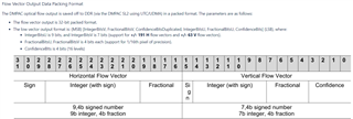

    I am dumping the flow_vector_field_out by modifying in ti-processor-sdk-rtos-j721e-evm-08_06_01_03/vision_apps/apps/basic_demos/app_dof/main.c. I am decoding the dumped flow_vector_field_out by referring to the picture below, but I am not sure if I am decoding it properly. Could you please check the attached code?
    Finally, I'm also attaching the python code that decodes and outputs it as an image. (read_board_output.py)

    def decode_flow_binary(data, h, w):
        flow_vector = np.zeros((h, w, 2))
        confidence_ = np.zeros((h, w))
        for idx in tqdm(range(0, len(data), 4)):
            confidence = data[idx] & 0x0f  # 0000 1111
            # vertical
            v_fraction = data[idx] & 0xf0 >> 4  # 1111 0000
            # v_integer = data[idx + 1] & 0x7f  # 0111 1111
            v_integer = data[idx + 1] & 0x3f  # 0011 1111 (excluded sign bit)
            v_sign = data[idx + 1] & 0x80 >> 7  # 1000 0000
            if v_sign == 1:
                v_sign = -1
            else:
                v_sign = 1
            # horizontal
            u_fraction = data[idx + 2] & 0x0f  # 0000 1111
            # u_integer = (data[idx + 3] & 0x1f << 4 | data[idx + 2] & 0xf0 >> 4)  # 0001 1111 | 1111 0000
            u_integer = (data[idx + 3] & 0x0f << 4 | data[idx + 2] & 0xf0 >> 4)  # 0000 1111 | 1111 0000 (excluded sign bit)
            # u_sign = data[idx + 3] & 0xe0 >> 5
            u_sign = data[idx + 3] & 0x10 >> 4
            if u_sign == 1:
                u_sign = -1
            else:
                u_sign = 1
            fx = u_sign * float((u_integer << 4) + u_fraction) / 16
            fy = v_sign * float((v_integer << 4) + v_fraction) / 16
            row = (idx // 4) // w
            col = (idx // 4) % w
            # print('row', row, 'col', col)
            if confidence > 6:
                flow_vector[row, col, 0] = fx
                flow_vector[row, col, 1] = fy
            confidence_[row, col] = confidence
        # for idx in tqdm(range(0, len(data), 4)):

    Hyeonseong
  • Hi Hyeonseong,
    Not sure about python script, but yes, the image is correct. This is output format of the flow vector.
    Brijesh
