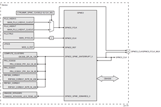

Then I tried to read and set the clock frequency for GPMC. Based on the TRM there is only two clock source possible for the GPMC FCLK: PLL0_HSDIV3 or PLL2_HSDIV7.

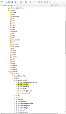

However in tisci_clocks.h 5 sources defined for GPMC:
Based on the above explanation, here are my questions:
1. I believe CLKB is the output clk of GPMC (2).  HSDIV3 and HSDIV7 are the inputs to the mux(5 and 6). ICLK (interface clk) is the same as clk_In (3). and FCLK_MUX_IN (4) is the output of the mux.Do you confirm that?
2. I tried to read the frequency of these different clocks and somehow set the frequency of the final FCLK, but the read values don't make sense. Also, it doesn't change the frequencies. Why?

3. based on the following clock tree, I checked PLL0 and PLL0_HSDIV3 and they are both enable and their outputs are enabled (they are all containing the default values set by SYSFW). Based on my calculation based on the data dump of the registers(provided in the table). the HSDIV3_CLKOUT should be 133 MHz. But what I see by using the Sciclient_pmGetModuleClkFreq function is 0 Hz. Why? Is this function supposed to work for GPMC on AM64x?
    To set the GPMC clock frequency, we need to call the below functions:
    SOC_moduleClockEnable(TISCI_DEV_GPMC0, 1); > Clock Enable
    SOC_moduleSetClockFrequency(TISCI_DEV_GPMC0,TISCI_DEV_GPMC0_FUNC_CLK,133333333);  > Set Clock Frequency
    Clock setting macros are available below. h file.
