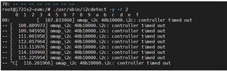

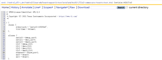

We want to implement I2C2 enable on the Linux side. Currently, we have encountered the issue of "controller timed out" after modifying it in the following way. We hope you can help analyze where our modifications were incorrect or need to be made elsewhere. Thank you very much.
Here are our modifications:
The file path is:  tda4/board-support/linux/arch/arm64/boot/dts/ti/k3-j721s2-common-proc-board.dts
The error log is as follows:

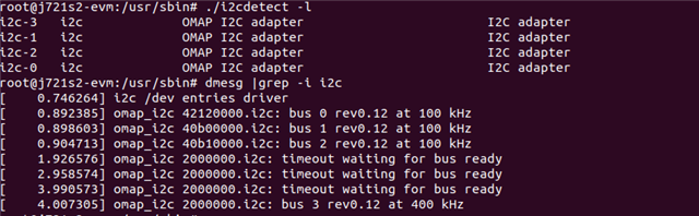

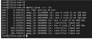

  • Hi Li,
    MAIN_I2C2 is a different instance: omap_i2c 2020000.i2c: bus 5 rev0.12 at 400 kHz
    So the timeouts that you are observing is from a different I2C - MCU_I2C1
    Can you double check if omap_i2c 2020000.i2c: is working fine?
    Keerthy

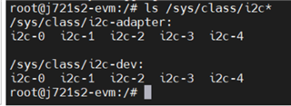

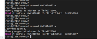

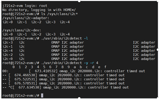

  • Hi ,
       We used the i2cdetect tool but did not recognize the correct main_I2C2. How do we configure this.
    BRs
    Somehow the main_i2c2 is not probed. Can you check if the status is set to okay or disabled in the device tree?
    Keerthy

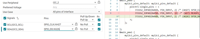

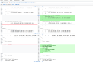

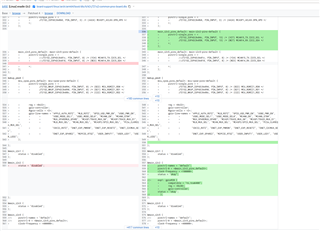

  • Here are our modifications and dts file:

    	main_i2c2_pins_default: main-i2c2-pins-default {
    		pinctrl-single,pins = <
    			J721S2_IOPAD(0x04c, PIN_INPUT, 13) /* (V27) MCAN15_TX.I2C2_SCL */
    			J721S2_IOPAD(0x050, PIN_INPUT, 13) /* (W27) MCAN14_RX.I2C2_SDA */

  • Hi Li,
    If you check Line number 338 the main_i2c2 is indeed probed and initialised. Does the freeze happen without the main_i2c2 dts changes? If not then main_i2c2 node or one of the child node may be causing this freeze.
    Keerthy

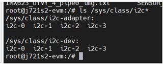

    The issue of interface stuck has been resolved, and the device tree modification is shown in the following figure.
    However, the i2c2 we configured has not yet been added to/sys/class/i2c-dev. I believe it is necessary to modify the following i2c logical mapping relationship, but the following mapping is defined in u-boot, and my attempts to modify it did not have any effect. Could you please tell me where the mapping relationship of i2c here is defined and how to enable this mapping relationship?
  • HI,
    According to the following modifications, our current progress is as follows:
    1. New i2c channels can be detected
    2. Our newly added i2c channel cannot display the devices mounted on it.
    We currently have the following questions:
    1. Why did we modify i2c2 but add i2c4?
    2. Which specific value do we need to change to for the compatible value of i2c2 that we have configured?
    3. This pcie1_ What is the role of the rc node here, and why can I only detect new i2c channels after adding ex3?
    In the device tree MAIN_I2C2 is assigned as i2c4 I believe and hence it comes up as i2c-4.
    Is it not probed/working already?
    This is a totally different topic. I request you to open a new thread & close this one.
    - Keerthy
  • hi,
    We currently have the following issues. Firstly, I can ensure that there are no hardware configuration issues. So how can I solve this problem? Please provide us with a clear plan or idea.
    With all your fixes, can you now share the output of:
    "dmesg | grep i2c"
    Is that now showing that main_2c2 is probed correctly? Controller time out can be due to wrong pin mux settings.
    Check if on your board the right pins are muxed for main_i2c2.
    - Keerthy
  • hi,
    Our modified main_ I2c2 node is the reference main_ I2c0 nodes have the same compatible value. Is this feasible or do you have any better suggestions? How should this value be set?
    Same IP different instance so the compatible value will be the same.
    - Keerthy

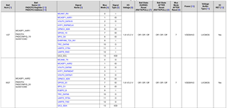

    As shown in the following figure, we need to change uart0 on the schematic to i2c2, so we need to set it to v27 and w27. But we tried the following modifications, but they didn't have any effect. We would like to ask if v27 and w27 cannot be used?
  • I2C2 can be supported on pins V27, W27.  These are connecting to nets 'UART9_RXD' and 'UART9_TXD' on your design.  Where do these connections go on our design, and are they connecting to UART or I2C peripherals?  Have you proved these signals to verify you see I2c communication attempted?
    In our default settings, v27 and w27 are set to uart9. We modified it to i2c2 through flying wires, and through measurement, we can observe a complete i2c signal waveform on the oscilloscope. We hope you can provide us with a modification plan for the device tree for verification. Thank you.
  • Hi Li,
    &main_pmx0 {
    	myi2c1_pins_default: myi2c1_pins_default {
    			J721S2_IOPAD(0x04c, PIN_INPUT, 13) /* (V27) MCASP1_AXR1.I2C2_SCL */
    			J721S2_IOPAD(0x050, PIN_INPUT, 13) /* (W27) MCASP1_AXR2.I2C2_SDA */
    Can you dump the pinmux register from Linux using the below commands:
    devmem2 0x4301c04C w
    devmem2 0x4301c050 w
    Please share the register values.
    - Keerthy
    The output results of these two commands are shown in the following figure:
    That's the reason. Whatever you are trying to configure from dts is not reflecting when we read from the registers.
    How are you hooking the main_i2c2_pins_default to the main_i2c2 node?
    Keerthy
    Due to my previous comment on (main_i2c2_pins_default), there was a problem with the pin pin. However, without commenting on the following two lines, the development board cannot start and enter Linux normally. The specific startup log is as follows:

    May I ask which file the modification was made in? I think the modified file may have been found incorrectly.
  • Hi Li,
    Without the above change the i2c2 will not work as you have seen the pinmux is not configured. Just defining the pins will not configure but you need to hook it to the respective DT node.
    On your board you will need to check why enabling pin mux for I2c2 causes boot hang.
    May be other module is requiring this to be in some other state.
  • Hi Li,
    Have you added this code in the j721s2-common-proc-board.dts?
    Please add this and read the registers that I asked you to read.
    Keerthy

    The following two files with the same name have both made the same modifications. After setting pinctl-name and pinctl-0 in the first dts file, the development board cannot enter Linux. The latter will not take effect after modification.
  • The first one is for Linux and that is where you are enabling i2c2. Please check if some other module is requiring the same pins in some other mode.
    - Keerthy
    Yes, I noticed a pin conflict. After modification, the development board can enter Linux normally. When I use i2cdetect - y - r 4 to detect i2c devices, an error is reported as follows:
  • When I use i2cdetect - y - r 4 to detect i2c devices, an error is reported as follows:
    Please read the main_i2c2 pin mux register values Also check in the boot log if main_i2c2 initialized without any errors.
    - Keerthy
  • HI,
    The mux register values and startup log are as follows:

    [    0.891707] omap_i2c 42120000.i2c: bus 0 rev0.12 at 100 kHz
    [    0.897952] omap_i2c 40b00000.i2c: bus 1 rev0.12 at 100 kHz
    [    0.904053] omap_i2c 40b10000.i2c: bus 2 rev0.12 at 100 kHz
    [    0.910444] pca953x 3-0021: supply vcc not found, using dummy regulator
    [    0.917281] pca953x 3-0021: using no AI
    [    0.941844] pca953x 3-0021: failed writing register
    [    0.946896] pca953x: probe of 3-0021 failed with error -121
    [    0.952858] pca953x 3-0020: supply vcc not found, using dummy regulator
    [    0.959681] pca953x 3-0020: using no AI
    [    0.963660] pca953x 3-0020: failed writing register
    [    0.968691] pca953x: probe of 3-0020 failed with error -121
    [    0.974581] pca953x 3-0022: supply vcc not found, using dummy regulator
    [    0.981385] pca953x 3-0022: using AI
    [    0.985091] pca953x 3-0022: failed writing register
    [    0.990118] pca953x: probe of 3-0022 failed with error -121
    [    0.995859] omap_i2c 2000000.i2c: bus 3 rev0.12 at 400 kHz
    [    1.002190] pca953x 4-0020: supply vcc not found, using dummy regulator
    [    1.009017] pca953x 4-0020: using no AI
    [    1.033857] pca953x 4-0020: failed writing register
    [    1.038896] pca953x: probe of 4-0020 failed with error -121
    [    1.044644] omap_i2c 2020000.i2c: bus 4 rev0.12 at 200 kHz
