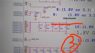

Hi, I am using TPS659037 to power AM5728, all TPS659037 's outputs are good except LDO4_OUT,  it is expected to be 1.8V, but  it is 2V in fact.( refer to:  https://e2e.ti.com/support/power-management-group/power-management/f/power-management-forum/1252022/tps659037-tps659037-issue/4740726#4740726)  Can am5728 work normally at this condition?(I do not use PCIe interface, and GPMC is 1.8V)

  • No other power supplies - then what supply/voltage is sourcing the PMIC?  Is that voltage (source to the PMIC) directly connected to the processor?  The fact that the IO is also 2V (and not 1.8V) indicates there is likely a incorrect power supply connection somewhere.
  • Hi Robert,  Perhaps you get me wrong or I did not express it clearly.
    The design's power supply follows the attached Picture absolutely.
    The question  is that , LDO4_OUT is 2V(it is expected to be 1.8V),  SMPS1_SMPS2 is about 1.18V(a bit larger than 1.15V),SMPS4_SMPS5 is about 1.09V(a bit larger than 1.06V)................
  • The power net VDDA_1V8_PHYB is supposed to be 1.8V, but rather is measuring 2V.  You say the design is absolutely same as the block diagram, but that is NOT correct as VDDA_1V8_PHYB also connects to VDDSHV10 - and that connection does not exist in the block diagram.
    I don't believe the issue is between the PMIC and the AM57 device, but possibly between the AM57 device and the rest of the system.
