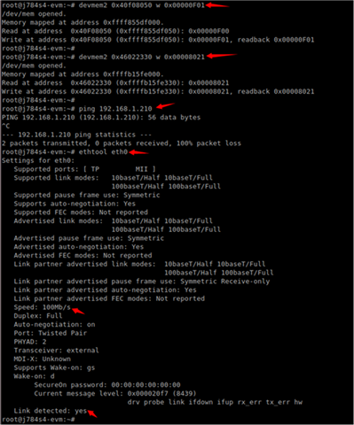

We could see the link is up & the speed is 100Mb/s shown in the below picture.

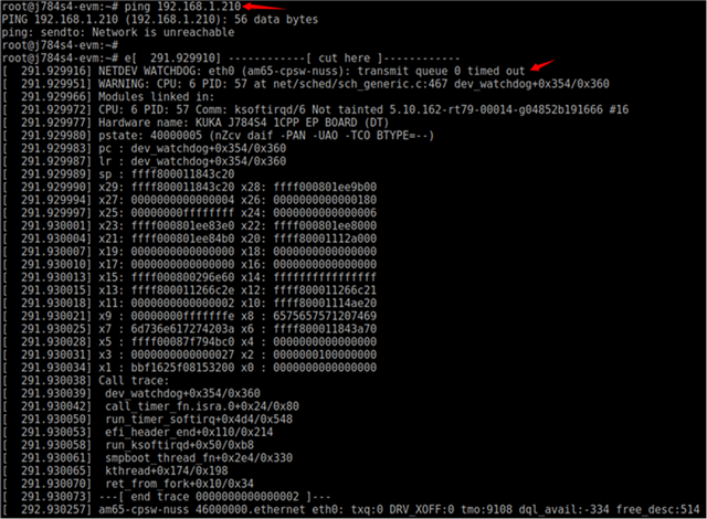

However, when we ping to PC, cpsw driver report a crash, showing as below.
eth0 (am65-cpsw-nuss): transmit queue 0 timed out

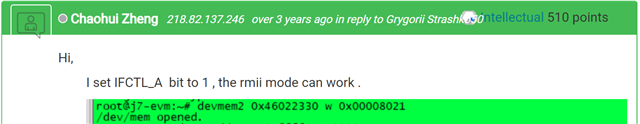

We have found that there is a similar problem shown in the below thread.
PROCESSOR-SDK-DRA8X-TDA4X: TDA4X MCU_CPSW0 RMII interfaces - Processors forum - Processors - TI E2E support forums
We have followed the suggestions to configure the registers 0x46022330, 0x40f08050, & set IFCTL_A bit to 1.
But this still cannot solve customer's problem.

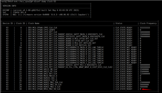

    • Here is my kernel boot log and the value of register "0x46022330"  is also shown in the log.
    • From the log, I can see the value of register 0x46022330 seems not correct before I write to it. But after I write value 0x00008021 to the register, it still cannot ping.

    [   10.466105] am65-cpsw-nuss 46000000.ethernet eth0: Link is Up - 100Mbps/Full - flow control rx/tx
     _____                    _____           _         _
    |  _  |___ ___ ___ ___   |  _  |___ ___  |_|___ ___| |_
    |     |  _| .'| . | . |  |   __|  _| . | | | -_|  _|  _|
    |__|__|_| |__,|_  |___|  |__|  |_| |___|_| |___|___|_|
                  |___|                    |___|
    Arago Project j784s4-evm ttyS2
    Arago 2021.09 j784s4-evm ttyS2
    j784s4-evm login: root
    root@j784s4-evm:~# ifconfig
    eth0: flags=4163<UP,BROADCAST,RUNNING,MULTICAST>  mtu 1500  metric 1
            ether 08:04:b4:2e:94:ea  txqueuelen 1000  (Ethernet)
            RX packets 0  bytes 0 (0.0 B)
            RX errors 0  dropped 0  overruns 0  frame 0
            TX packets 4  bytes 1336 (1.3 KiB)
            TX errors 0  dropped 0 overruns 0  carrier 0  collisions 0
    lo: flags=73<UP,LOOPBACK,RUNNING>  mtu 65536  metric 1
            inet 127.0.0.1  netmask 255.0.0.0
            loop  txqueuelen 1000  (Local Loopback)
            RX packets 82  bytes 6220 (6.0 KiB)
            TX packets 82  bytes 6220 (6.0 KiB)
    root@j784s4-evm:~# ethtool -i eth0
    driver: am65-cpsw-nuss
    version: 6.1.33-rt11-00016-g4da34e2a3d3a
    firmware-version:
    expansion-rom-version:
    bus-info: 46000000.ethernet
    supports-statistics: yes
    supports-test: no
    supports-eeprom-access: no
    supports-register-dump: yes
    supports-priv-flags: yes
    root@j784s4-evm:~#
    root@j784s4-evm:~# ethtool eth0
    Settings for eth0:
       Supported ports: [ TP         MII ]
       Supported link modes:   10baseT/Half 10baseT/Full
                               100baseT/Half 100baseT/Full
       Supported pause frame use: Symmetric
       Supports auto-negotiation: Yes
       Supported FEC modes: Not reported
       Advertised link modes:  10baseT/Half 10baseT/Full
       Advertised pause frame use: Symmetric
       Advertised auto-negotiation: Yes
       Advertised FEC modes: Not reported
       Link partner advertised link modes:  10baseT/Half 10baseT/Full
       Link partner advertised pause frame use: Symmetric Receive-only
       Link partner advertised auto-negotiation: Yes
       Link partner advertised FEC modes: Not reported
       Speed: 100Mb/s
       Duplex: Full
       Auto-negotiation: on
       Port: Twisted Pair
       PHYAD: 2
       Transceiver: external
       MDI-X: Unknown
       Supports Wake-on: gs
       Wake-on: d
            SecureOn password: 00:00:00:00:00:00
            Current message level: 0x000020f7 (8439)
                                   drv probe link ifdown ifup rx_err tx_err hw
       Link detected: yes
    root@j784s4-evm:~#
    root@j784s4-evm:~# ifconfig eth0 192.168.1.10 netmask 255.255.255.0
    root@j784s4-evm:~# ping 192.168.1.100
    PING 192.168.1.100 (192.168.1.100): 56 data bytes
    ^C
    --- 192.168.1.100 ping statistics ---
    3 packets transmitted, 0 packets received, 100% packet loss
    root@j784s4-evm:~#

    root@j784s4-evm:~# devmem2 0x46022330 w
    /dev/mem opened.
    Memory mapped at address 0xffffa1b16000.
    Read at address  0x46022330 (0xffffa1b16330): 0x00008039
    root@j784s4-evm:~#
    root@j784s4-evm:~# devmem2 0x46022330 w 0x00008021
    /dev/mem opened.
    Memory mapped at address 0xffff9fd4b000.
    Read at address  0x46022330 (0xffff9fd4b330): 0x00008039
    Write at address 0x46022330 (0xffff9fd4b330): 0x00008021, readback 0x00008021
    root@j784s4-evm:~#
    root@j784s4-evm:~# [  224.989209] ------------[ cut here ]------------
    [  224.989215] NETDEV WATCHDOG: eth0 (am65-cpsw-nuss): transmit queue 0 timed out
    [  224.989247] WARNING: CPU: 6 PID: 66 at net/sched/sch_generic.c:525 dev_watchdog+0x224/0x230
    [  224.989266] Modules linked in:
    [  224.989272] CPU: 6 PID: 66 Comm: ktimers/6 Not tainted 6.1.33-rt11-00016-g4da34e2a3d3a #29 bb6cbeaf8f6645687a45443dd9bbc9df3d3eeb46
    [  224.989278] Hardware name: KUKA J784S4 1CPP EP BOARD (DT)
    [  224.989281] pstate: 40000005 (nZcv daif -PAN -UAO -TCO -DIT -SSBS BTYPE=--)
    [  224.989284] pc : dev_watchdog+0x224/0x230
    [  224.989289] lr : dev_watchdog+0x224/0x230
    [  224.989293] sp : ffff800009adbc50
    [  224.989294] x29: ffff800009adbc50 x28: ffff00087f776240 x27: ffff0008024f04a8
    [  224.989299] x26: ffff800009adbd30 x25: ffff800009adbd30 x24: ffff00087f776250
    [  224.989303] x23: ffff800009378000 x22: 0000000000000000 x21: ffff0008024f03e0
    [  224.989307] x20: ffff0008024f0000 x19: ffff0008024f04a8 x18: 0000000000000000
    [  224.989311] x17: 6f2064656d697420 x16: 3020657565757120 x15: 74696d736e617274
    [  224.989315] x14: 203a297373756e2d x13: 74756f2064656d69 x12: 7420302065756575
    [  224.989320] x11: 712074696d736e61 x10: 7274203a29737375 x9 : 777370632d35366d
    [  224.989324] x8 : ffff8000093908d8 x7 : ffff800009adba50 x6 : 00000000fffff16c
    [  224.989328] x5 : ffff00087f775c50 x4 : 0000000000000000 x3 : 0000000000000027
    [  224.989332] x2 : 0000000100000000 x1 : ce86b8dc6048f600 x0 : 0000000000000000
    [  224.989337] Call trace:
    [  224.989339]  dev_watchdog+0x224/0x230
    [  224.989343]  call_timer_fn.isra.0+0x24/0x80
    [  224.989351]  run_timer_softirq+0x4d4/0x548
    [  224.989356]  _stext+0x110/0x21c
    [  224.989359]  run_timersd+0x64/0xc0
    [  224.989364]  smpboot_thread_fn+0x2b8/0x2f8
    [  224.989369]  kthread+0x128/0x138
    [  224.989374]  ret_from_fork+0x10/0x20
    [  224.989378] ---[ end trace 0000000000000000 ]---
    [  224.989386] am65-cpsw-nuss 46000000.ethernet eth0: txq:0 DRV_XOFF:0 tmo:8092 dql_avail:-334 free_desc:514
    [  230.877214] am65-cpsw-nuss 46000000.ethernet eth0: txq:0 DRV_XOFF:0 tmo:13980 dql_avail:-334 free_desc:514
    ^C
    4 packets transmitted, 0 packets received, 100% packet loss
    root@j784s4-evm:~# [  235.997208] am65-cpsw-nuss 46000000.ethernet eth0: txq:0 DRV_XOFF:0 tmo:19100 dql_avail:-334 free_desc:514
    [  241.885212] am65-cpsw-nuss 46000000.ethernet eth0: txq:0 DRV_XOFF:0 tmo:24988 dql_avail:-334 free_desc:514
    [  246.749210] am65-cpsw-nuss 46000000.ethernet eth0: txq:0 DRV_XOFF:0 tmo:29852 dql_avail:-334 free_desc:514
    [  251.869211] am65-cpsw-nuss 46000000.ethernet eth0: txq:0 DRV_XOFF:0 tmo:34972 dql_avail:-334 free_desc:514
    [  256.989208] am65-cpsw-nuss 46000000.ethernet eth0: txq:0 DRV_XOFF:0 tmo:40092 dql_avail:-334 free_desc:514
    [  262.877210] am65-cpsw-nuss 46000000.ethernet eth0: txq:0 DRV_XOFF:0 tmo:45980 dql_avail:-334 free_desc:514
    [  267.997209] am65-cpsw-nuss 46000000.ethernet eth0: txq:0 DRV_XOFF:0 tmo:51100 dql_avail:-334 free_desc:514
    [  273.885211] am65-cpsw-nuss 46000000.ethernet eth0: txq:0 DRV_XOFF:0 tmo:56988 dql_avail:-334 free_desc:514
    [  278.749210] am65-cpsw-nuss 46000000.ethernet eth0: txq:0 DRV_XOFF:0 tmo:61852 dql_avail:-334 free_desc:514
    [  283.869208] am65-cpsw-nuss 46000000.ethernet eth0: txq:0 DRV_XOFF:0 tmo:66972 dql_avail:-334 free_desc:514
    [  288.989208] am65-cpsw-nuss 46000000.ethernet eth0: txq:0 DRV_XOFF:0 tmo:72092 dql_avail:-334 free_desc:514

    root@j784s4-evm:~/mcu_cpsw2g#
    root@j784s4-evm:~/mcu_cpsw2g# uname -a
    Linux j784s4-evm 5.10.162-00001-g4f12ba8f0bb6 #2 SMP PREEMPT Sat Jul 29 18:05:40 CST 2023 aarch64 aarch64 aarch64 GNU/Linux
    root@j784s4-evm:~/mcu_cpsw2g# dmesg | grep KUKA
    [    0.000000] Machine model: KUKA J784S4 1CPP EP BOARD
    root@j784s4-evm:~/mcu_cpsw2g# ethtool eth0
    Settings for eth0:
       Speed: 100Mb/s
       Duplex: Full
       Port: Twisted Pair
       PHYAD: 2
       MDI-X: Unknown
       Wake-on: d
       Link detected: yes
    root@j784s4-evm:~/mcu_cpsw2g# dmesg | grep -E 'mdio|cpsw'
    [    3.428270] davinci_mdio 46000f00.mdio: davinci mdio revision 9.7, bus freq 1000000
    [    3.437780] davinci_mdio 46000f00.mdio: phy[2]: device 46000f00.mdio:02, driver TI DP83822
    [    3.446063] am65-cpsw-nuss 46000000.ethernet: initializing am65 cpsw nuss version 0x6BA02102, cpsw version 0x6BA82102 Ports: 2 quirks:00000000
    [    3.458898] am65-cpsw-nuss 46000000.ethernet: initialized cpsw ale version 1.4
    [    3.466103] am65-cpsw-nuss 46000000.ethernet: ALE Table size 64
    [    3.472387] am65-cpsw-nuss 46000000.ethernet: CPTS ver 0x4e8a010b, freq:500000000, add_val:1 pps:0
    [    3.660269] davinci_mdio 46000f00.mdio: davinci mdio revision 9.7, bus freq 1000000
    [    3.669642] davinci_mdio 46000f00.mdio: phy[2]: device 46000f00.mdio:02, driver TI DP83822
    [    3.677926] am65-cpsw-nuss 46000000.ethernet: initializing am65 cpsw nuss version 0x6BA02102, cpsw version 0x6BA82102 Ports: 2 quirks:00000000
    [    3.690754] am65-cpsw-nuss 46000000.ethernet: initialized cpsw ale version 1.4
    [    3.697960] am65-cpsw-nuss 46000000.ethernet: ALE Table size 64
    [    3.704216] am65-cpsw-nuss 46000000.ethernet: CPTS ver 0x4e8a010b, freq:500000000, add_val:1 pps:0
    [    3.714257] am65-cpsw-nuss 46000000.ethernet: set new flow-id-base 48
    [    6.580035] am65-cpsw-nuss 46000000.ethernet eth0: PHY [46000f00.mdio:02] driver [TI DP83822] (irq=POLL)
    [    6.592256] am65-cpsw-nuss 46000000.ethernet eth0: configuring for phy/rmii link mode
    [    9.677139] am65-cpsw-nuss 46000000.ethernet eth0: Link is Up - 100Mbps/Full - flow control rx/tx

          We find one cpsw CLK problem in SOC, and two problems in PHY status register:
          1. cpsw CLK problem
    the mcu CPSW2G use internel 50MHz clock defaultly:
    but there is no clock seen from clk measurement dump:
        2. the two prolems in DP83822 PHY status register:
         3. RESET signal affects REF_CLK clock
           if connect Reset from SoC to PHY, the 50MHz REF_CLK outputs incorrectly, now we only use power-up RC reset, disconnect the reset from SoC to PHY, which means there is no hot-reset for PHY, is there any issue if we do so?
    Best Regards!
    Johnson.Xu
    As per the value CPSW is configured for Internal RMII clock.
    Selects the rmii clock (rmii_mhz_50_clk) source. This defaults to the internal 50 MHz clock source.
    0h - MCU_PLL2_HSDIV0_CLKOUT / 5
    1h - MCU_RMII_REFCLK (pin)
    Can you please set the CTRL_MMR_CFG0_MCU_ENET_CLKSEL register (0x40F08050) .MCU_ENET_CLKSEL_RMII_CLK_SEL to 1 (i.e. bit 0 to 1)  for external clock usage and check once.
    Sudheer
