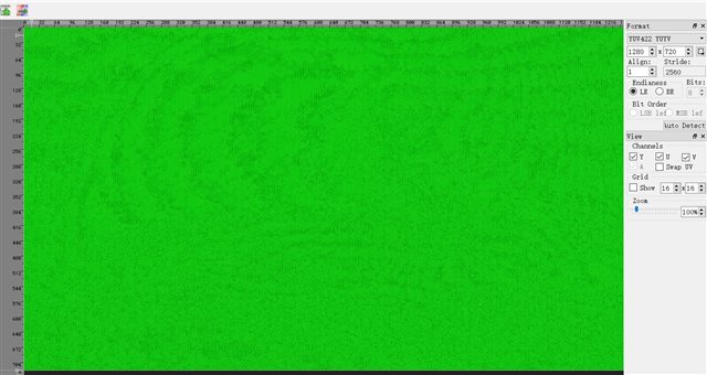

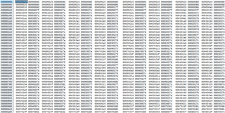

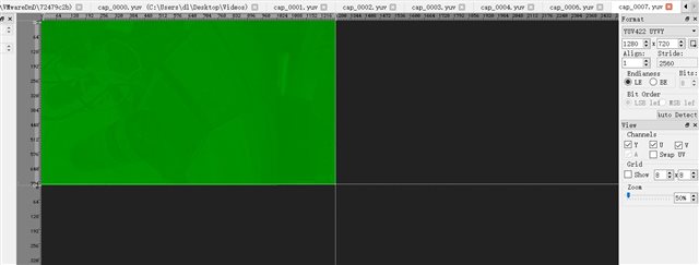

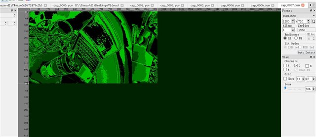

    Thanks and here're 3 questions may also need your help:
    1) Does demo of run_app_single_cam push to screen? Is additional configuration required? Is it the default push to DISPLAY0 (DP0)?
    2) When selecting camera port ports, select camera port index 0-11 :  what interfaces do these ports correspond to? For example, in CSI0, the deserializer can be connected to four cameras, which port is the first camera?
    Error : Failed to start sensor at channel Id 0
    Based on the above error, the camera fails to open. The YUV camera is powered on automatically, the PowerOn function is not empty. So does the error indicate that the camera failed to open or failed to get the video stream?
    3) log information: get_dcc_dir_size : Could not open directory or directory is empty /opt/vision_apps/dcc/MAX96705_AR0147_UYVY/wdr
    Depending on the camera manufacturer, changing the camera model does not require configuring the WDR parameters. Are these settings necessary?

     Enter Choice: s
    Test data path /opt/vision_apps/test_data does not exist. Defaulting to current folder
    YUV file name .//cap_0000.yuv
    imgaddr_width = 1280
    imgaddr_height = 720
    imgaddr_stride = 2560
    width = 1280
    height = 720
    Written 1843200 bytes

     Enter Choice: s
    width = 1280
    height = 720
     Demo : Single Camera w/ 2A
     p: Print performance statistics
     s: Save Sensor RAW, VISS Output and H3A output images to File System
     e: Export performance statistics
     u: Update DCC from File System
     x: Exit
     Enter Choice:
    Unsupported command
     x: Exit
     Enter Choice:
    cap_000.yuv open by 7yuv in the mode yuv422

    the FPS is correct.
    cap_00.yuv open by 7yuv in mode of yuv422 UYUV, this is nothing.
    open in other mode as follows we can get something in picture, can you help us!
    Is it possible to share this image? I think it is capturing image, but just probably order of YUV is incorrect. So if you try all 4 options for YUV422, i thinnk one of them should give you correct image.
    Brijesh
  • hi,we have try all options for yuv422, it doesn't work. The iamge is follows.Thinks
    cap_0007.rar
    Are you sure this is YUV422 data? Because i dont see MSB byte set in the output. Also, second byte seems to be having very less value. Please find below snapshot of the data in hex viewer. This does not look like YUV422 data.
