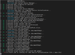

TDA4VM: I encounter a problem where there is a 2-minute delay during the boot process when loading the native driver on the VM development board
Part Number: TDA4VM
Hi, TI experts
I downloaded the ti-processor-sdk-rtos-j721e-evm-08_06_00_12-prebuilt.tar.gz package from the official website, and then made the following modifications to the install_to_sd_card.sh file
Then, I flash the generated boot and rootfs onto the SD card, and the VM development board can start up successfully.
I downloaded the ti-processor-sdk-linux-j7-evm-08_06_00_11-Linux-x86-Install.bin package from the official website. After installation, I compiled the k3-j721e-gesi-exp-board.dtb device tree file and downloaded it to the /boot directory on the board.
I modified the uEnv.txt file in the first partition of the SD card to make the system load the k3-j721e-gesi-exp-board.dtb device tree file. The modification is as follows.
When I restart the board, the system prompts to enter emergency mode, and after pressing Control-D, it takes 2 minutes to wait.
How can I locate the problem and solve it
Regards, Albert

  • Hi Keerthy,
    I have tried remaking the SD card several times, but I still encounter the same issue. I searched on a forum and found a suggestion to mitigate the problem by using “systemd-udev-settle mask systemd-udev-settle”. However, even after applying this workaround and rebooting the system using the “reboot” command, I still experience system reboot failure. Therefore, I would like to inquire about the specific cause of the problem or methods to diagnose it.
    Albert

    I have successfully loaded k3-j721e-vision-apps. dtbo and gesi device tree. The system can reboot normally, but it will enter emergency mode every time it starts. The log is as follows

    [    7.461875] random: systemd: uninitialized urandom read (16 bytes read)
    [    7.469121] systemd[1]: Created slice User and Session Slice.
    [  OK  ] Created slice User and Session Slice.
    [    7.490007] systemd[1]: Started Dispatch Password Requests to Console Directory Watch.
    [  OK  ] Started Dispatch Password …ts to Console Directory Watch.
    [    7.513926] systemd[1]: Started Forward Password Requests to Wall Directory Watch.
    [  OK  ] Started Forward Password R…uests to Wall Directory Watch.
    [    7.537918] systemd[1]: Reached target Paths.
    [  OK  ] Reached target Paths.
    [    7.553860] systemd[1]: Reached target Remote File Systems.
    [  OK  ] Reached target Remote File Systems.
    [    7.573851] systemd[1]: Reached target Slices.
    [  OK  ] Reached target Slices.
    [    7.589856] systemd[1]: Reached target Swap.
    [  OK  ] Reached target Swap.
    [    7.615725] systemd[1]: Listening on RPCbind Server Activation Socket.
    [  OK  ] Listening on RPCbind Server Activation Socket.
    [    7.637930] systemd[1]: Reached target RPC Port Mapper.
    [  OK  ] Reached target RPC Port Mapper.
    [    7.661978] systemd[1]: Listening on Process Core Dump Socket.
    [  OK  ] Listening on Process Core Dump Socket.
    [    7.682019] systemd[1]: Listening on initctl Compatibility Named Pipe.
    [  OK  ] Listening on initctl Compatibility Named Pipe.
    [    7.707564] systemd[1]: Condition check resulted in Journal Audit Socket being skipped.
    [    7.715918] systemd[1]: Listening on Journal Socket (/dev/log).
    [  OK  ] Listening on Journal Socket (/dev/log).
    [    7.738119] systemd[1]: Listening on Journal Socket.
    [  OK  ] Listening on Journal Socket.
    [    7.754168] systemd[1]: Listening on Network Service Netlink Socket.
    [  OK  ] Listening on Network Service Netlink Socket.
    [    7.778075] systemd[1]: Listening on udev Control Socket.
    [  OK  ] Listening on udev Control Socket.
    [    7.797984] systemd[1]: Listening on udev Kernel Socket.
    [  OK  ] Listening on udev Kernel Socket.
    [    7.820109] systemd[1]: Mounting Huge Pages File System...
    [    7.840104] systemd[1]: Mounting POSIX Message Queue File System...
    [    7.864067] systemd[1]: Mounting Kernel Debug File System...
    [    7.886589] systemd[1]: Mounting Temporary Directory (/tmp)...
    [    7.904268] systemd[1]: Starting Create list of static device nodes for the current kernel...
             Starting Create list of st…odes for the current kernel...
    [    7.940293] systemd[1]: Starting Start psplash boot splash screen...
    [    7.964172] systemd[1]: Starting RPC Bind...
    [    7.986039] systemd[1]: Condition check resulted in File System Check on Root Device being skipped.
    [    7.998046] systemd[1]: Starting Journal Service...
    [    8.028104] systemd[1]: Starting Load Kernel Modules...
    [    8.044178] systemd[1]: Starting Remount Root and Kernel File Systems...
    [    8.062820] EXT4-fs (mmcblk1p2): re-mounted. Opts: (null)
    [    8.068469] cryptodev: loading out-of-tree module taints kernel.
    [    8.077223] systemd[1]: Starting udev Coldplug all Devices...
    [    8.078857] cryptodev: driver 1.10 loaded.
    [    8.104800] systemd[1]: Started RPC Bind.
    [  OK  ] Started RPC Bind.
    [    8.126398] systemd[1]: Started Journal Service.
    [  OK  ] Started Journal Service.
    [  OK  ] Mounted Huge Pages File System.
    [  OK  ] Mounted POSIX Message Queue File System.
    [  OK  ] Mounted Kernel Debug File System.
    [  OK  ] Mounted Temporary Directory (/tmp).
    [  OK  ] Started Create list of sta… nodes for the current kernel.
    [FAILED] Failed to start Start psplash boot splash screen.
    See 'systemctl status psplash-start.service' for details.
    [DEPEND] Dependency failed for Star…progress communication helper.
    [  OK  ] Started Load Kernel Modules.
    [  OK  ] Started Remount Root and Kernel File Systems.
             Mounting Kernel Configuration File System...
             Starting Flush Journal to Persistent Storage...
    [    8.347866] systemd-journald[195]: Received client request to flush runtime journal.
             Starting Apply Kernel Variables...
             Starting Create Static Device Nodes in /dev...
    [  OK  ] Mounted Kernel Configuration File System.
    [  OK  ] Started Flush Journal to Persistent Storage.
    [  OK  ] Started Apply Kernel Variables.
    [  OK  ] Started Create Static Device Nodes in /dev.
    [    8.466459] random: systemd: uninitialized urandom read (16 bytes read)
    [  OK  ] Reached target Local File Systems (Pre).
    [    8.489969] random: systemd: uninitialized urandom read (16 bytes read)
             Mounting /media/ram...
    [    8.502310] random: systemd-journal: uninitialized urandom read (16 bytes read)
             Mounting /var/volatile...
             Starting udev Kernel Device Manager...
    [  OK  ] Started udev Coldplug all Devices.
    [  OK  ] Mounted /media/ram.
    [  OK  ] Mounted /var/volatile.
             Starting udev Wait for Complete Device Initialization...
             Starting Load/Save Random Seed...
    [  OK  ] Reached target Local File Systems.
             Starting Create Volatile Files and Directories...
    [  OK  ] Started udev Kernel Device Manager.
    [  OK  ] Started Create Volatile Files and Directories.
             Starting Network Time Synchronization...
             Starting Update UTMP about System Boot/Shutdown...
    [  OK  ] Started Update UTMP about System Boot/Shutdown.
    [  OK  ] Started Network Time Synchronization.
    [  OK  ] Reached target System Time Set.
    [  OK  ] Reached target System Time Synchron[    8.872194] random: crng init done
    ized.
    [    8.880920] random: 66 urandom warning(s) missed due to ratelimiting
    [  OK  ] Started Load/Save Random Seed.[    8.902175] ina2xx 4-0040: power monitor ina226 (Rshunt = 10000 uOhm)
    [    8.914799] ina2xx 4-0041: power monitor ina226 (Rshunt = 10000 uOhm)
    [    8.922866] ina2xx 4-0042: power monitor ina226 (Rshunt = 10000 uOhm)
    [    8.930641] ina2xx 4-0043: power monitor ina226 (Rshunt = 10000 uOhm)
    [    8.938367] ina2xx 4-0044: power monitor ina226 (Rshunt = 10000 uOhm)
    [    8.945731] ina2xx 4-0045: power monitor ina226 (Rshunt = 5000 uOhm)
    [    8.953682] ina2xx 4-0046: power monitor ina226 (Rshunt = 10000 uOhm)
    [    8.961411] ina2xx 4-0047: power monitor ina226 (Rshunt = 10000 uOhm)
    [    8.969247] ina2xx 4-0048: power monitor ina226 (Rshunt = 10000 uOhm)
    [    8.976996] ina2xx 4-0049: power monitor ina226 (Rshunt = 10000 uOhm)
    [    8.984729] ina2xx 4-004a: power monitor ina226 (Rshunt = 10000 uOhm)
    [    8.992520] ina2xx 4-004b: power monitor ina226 (Rshunt = 10000 uOhm)
    [    9.000285] ina2xx 4-004c: power monitor ina226 (Rshunt = 10000 uOhm)
    [    9.008035] ina2xx 4-004d: power monitor ina226 (Rshunt = 10000 uOhm)
    [    9.015789] ina2xx 4-004e: power monitor ina226 (Rshunt = 10000 uOhm)
    [    9.023528] ina2xx 4-004f: power monitor ina226 (Rshunt = 10000 uOhm)
    [    9.063121] CAN device driver interface
    [    9.128923] k3-dsp-rproc 4d80800000.dsp: assigned reserved memory node vision-apps-c66-dma-memory@a9000000
    [    9.159315] k3-dsp-rproc 4d80800000.dsp: configured DSP for IPC-only mode
    [    9.166262] remoteproc remoteproc0: 4d80800000.dsp is available
    [    9.173566] remoteproc remoteproc0: attaching to 4d80800000.dsp
    [    9.180183] k3-dsp-rproc 4d80800000.dsp: DSP initialized in IPC-only mode
    [    9.187731]  remoteproc0#vdev0buffer: assigned reserved memory node vision-apps-c66-dma-memory@a9000000
    [    9.197650] virtio_rpmsg_bus virtio0: rpmsg host is online
    [    9.203297] virtio_rpmsg_bus virtio0: creating channel rpmsg_chrdev addr 0xd
    [    9.212361]  remoteproc0#vdev0buffer: registered virtio0 (type 7)
    [    9.218658] remoteproc remoteproc0: remote processor 4d80800000.dsp is now attached
    [    9.229656] pvrsrvkm 4e20000000.gpu: More than one power domain for this GPU, gpu driver manages power domains
    [    9.240798] k3-dsp-rproc 4d81800000.dsp: assigned reserved memory node vision-apps-c66-dma-memory@a8000000
    [    9.255785] k3-dsp-rproc 4d81800000.dsp: configured DSP for IPC-only mode
    [    9.263462] remoteproc remoteproc1: 4d81800000.dsp is available
    [    9.270929] remoteproc remoteproc1: attaching to 4d81800000.dsp
    [    9.277530] PVR_K:  228: Read BVNC 22.104.208.318 from HW device registers
    [    9.285678] k3-dsp-rproc 4d81800000.dsp: DSP initialized in IPC-only mode
    [    9.293306] PVR_K:  228: RGX Device registered with BVNC 22.104.208.318
    [    9.293694]  remoteproc1#vdev0buffer: assigned reserved memory node vision-apps-c66-dma-memory@a8000000
    [    9.312469] virtio_rpmsg_bus virtio1: rpmsg host is online
    [    9.318561] virtio_rpmsg_bus virtio1: creating channel rpmsg_chrdev addr 0xd
    [    9.327153]  remoteproc1#vdev0buffer: registered virtio1 (type 7)
    [    9.334571] remoteproc remoteproc1: remote processor 4d81800000.dsp is now attached
    [    9.335203] [drm] Initialized pvr 1.15.6133109 20170530 for 4e20000000.gpu on minor 0
    [    9.353432] k3-dsp-rproc 64800000.dsp: assigned reserved memory node vision-apps-c71-dma-memory@b2000000
    [    9.368903] k3-dsp-rproc 64800000.dsp: configured DSP for IPC-only mode
    [    9.377547] remoteproc remoteproc2: 64800000.dsp is available
    [    9.383527] remoteproc remoteproc2: attaching to 64800000.dsp
    [    9.389545] remoteproc remoteproc2: unsupported resource 65538
    [    9.395698] k3-dsp-rproc 64800000.dsp: DSP initialized in IPC-only mode
    [    9.402538]  remoteproc2#vdev0buffer: assigned reserved memory node vision-apps-c71-dma-memory@b2000000
    [    9.412382] virtio_rpmsg_bus virtio2: rpmsg host is online
    [    9.417933] virtio_rpmsg_bus virtio2: creating channel rpmsg_chrdev addr 0xd
    [    9.425576]  remoteproc2#vdev0buffer: registered virtio2 (type 7)
    [    9.432229] platform 41000000.r5f: R5F core may have been powered on by a different host, programmed state (0) != actual state (1)
    [    9.439226] remoteproc remoteproc2: remote processor 64800000.dsp is now attached
    [    9.462552] img_enc 4200000.video-encoder: vxe_enc_probe: using heap 1 for internal alloc
    [    9.483595] platform 41000000.r5f: configured R5F for IPC-only mode
    [    9.491385] img_dec 4300000.video-decoder: decoder registered as /dev/video0
    [    9.526143] img_enc 4200000.video-encoder: encoder registered as /dev/video1
    [    9.552490] platform 41000000.r5f: assigned reserved memory node vision-apps-r5f-dma-memory@a0000000
    [    9.574487] remoteproc remoteproc3: 41000000.r5f is available
    [    9.594504] remoteproc remoteproc3: attaching to 41000000.r5f
    [    9.607523] platform 41000000.r5f: R5F core initialized in IPC-only mode
    [    9.623744]  remoteproc3#vdev0buffer: assigned reserved memory node vision-apps-r5f-dma-memory@a0000000
    [    9.642820] virtio_rpmsg_bus virtio3: rpmsg host is online
    [    9.655456] virtio_rpmsg_bus virtio3: creating channel ti.ipc4.ping-pong addr 0xd
    [    9.663695] m_can_platform 40528000.can: m_can device registered (irq=22, version=32)
    [    9.673225] virtio_rpmsg_bus virtio3: creating channel rpmsg_chrdev addr 0xe
    [    9.688090] m_can_platform 40568000.can: m_can device registered (irq=24, version=32)
    [    9.696079]  remoteproc3#vdev0buffer: registered virtio3 (type 7)
    [    9.702344] m_can_platform 2701000.can: m_can device registered (irq=47, version=32)
    [    9.717891] m_can_platform 2721000.can: m_can device registered (irq=49, version=32)
    [    9.750935] remoteproc remoteproc3: remote processor 41000000.r5f is now attached
    [    9.799962] platform 5c00000.r5f: configured R5F for remoteproc mode
    [    9.856004] platform 5c00000.r5f: assigned reserved memory node vision-apps-r5f-dma-memory@a2000000
    [    9.887508] remoteproc remoteproc4: 5c00000.r5f is available
    [    9.895783] platform 5d00000.r5f: configured R5F for remoteproc mode
    [    9.905247] remoteproc remoteproc4: powering up 5c00000.r5f
    [    9.911029] remoteproc remoteproc4: Booting fw image pdk-ipc/ipc_echo_test_mcu2_0_release_strip.xer5f, size 98828
    [    9.924778]  remoteproc4#vdev0buffer: assigned reserved memory node vision-apps-r5f-dma-memory@a2000000
    [    9.935839] virtio_rpmsg_bus virtio4: rpmsg host is online
    [    9.941403]  remoteproc4#vdev0buffer: registered virtio4 (type 7)
    [    9.949944] remoteproc remoteproc4: remote processor 5c00000.r5f is now up
    [    9.959864] virtio_rpmsg_bus virtio4: creating channel ti.ipc4.ping-pong addr 0xd
    [    9.967575] virtio_rpmsg_bus virtio4: creating channel rpmsg_chrdev addr 0xe
    [    9.984745] platform 5d00000.r5f: assigned reserved memory node vision-apps-r5f-dma-memory@a4000000
    [   10.027270] remoteproc remoteproc5: 5d00000.r5f is available
    [   10.051223] remoteproc remoteproc5: powering up 5d00000.r5f
    [   10.056943] remoteproc remoteproc5: Booting fw image j7-main-r5f0_1-fw, size 302028
    [   10.065988] platform 5e00000.r5f: configured R5F for remoteproc mode
    [   10.075039]  remoteproc5#vdev0buffer: assigned reserved memory node vision-apps-r5f-dma-memory@a4000000
    [   10.087395] virtio_rpmsg_bus virtio5: rpmsg host is online
    [   10.097062]  remoteproc5#vdev0buffer: registered virtio5 (type 7)
    [   10.103222] remoteproc remoteproc5: remote processor 5d00000.r5f is now up
    [   10.120039] platform 5e00000.r5f: assigned reserved memory node vision-apps-r5f-dma-memory@a6000000
    [   10.138622] remoteproc remoteproc6: 5e00000.r5f is available
    [   10.151488] remoteproc remoteproc6: Direct firmware load for j7-main-r5f1_0-fw failed with error -2
    [   10.163538] remoteproc remoteproc6: powering up 5e00000.r5f
    [   10.172283] remoteproc remoteproc6: Direct firmware load for j7-main-r5f1_0-fw failed with error -2
    [   10.182429] platform 5f00000.r5f: configured R5F for remoteproc mode
    [   10.188903] remoteproc remoteproc6: request_firmware failed: -2
    [   10.195020] virtio_rpmsg_bus virtio5: creating channel rpmsg_chrdev addr 0xd
    [   10.215974] platform 5f00000.r5f: assigned reserved memory node vision-apps-r5f-dma-memory@a7000000
    [   10.237298] remoteproc remoteproc7: 5f00000.r5f is available
    [   10.270035] remoteproc remoteproc7: Direct firmware load for j7-main-r5f1_1-fw failed with error -2
    [   10.283103] remoteproc remoteproc7: powering up 5f00000.r5f
    [   10.288745] remoteproc remoteproc7: Direct firmware load for j7-main-r5f1_1-fw failed with error -2
    [   10.301208] remoteproc remoteproc7: request_firmware failed: -2
    [  OK  ] Created slice system-systemd\x2dfsck.slice.
    [  OK  ] Found device /dev/mmcblk0p1.
             Starting File System Check on /dev/mmcblk0p1...
    [FAILED] Failed to start File System Check on /dev/mmcblk0p1.
    See 'systemctl status systemd-fsck@dev-mmcblk0p1.service' for details.
    [   11.349711] usbcore: registered new interface driver usbfs
    [DEPEND] Dependency failed for /run/media/mmcblk0p1.
    [   11.362564] remoteproc remoteproc8: b034000.pru is available
    [  OK  ] Found device /dev/mmcblk0p8.
    [  OK  ] Stopped Dispatch Password …ts to Console Directory Watch.
    [   11.396562] usbcore: registered new interface driver hub
    [   11.396869] remoteproc remoteproc9: b004000.rtu is available
    [   11.415144] remoteproc remoteproc10: b00a000.txpru is available
    [  OK  ] Stopped Forward Password R…uests [   11.422512] usbcore: registered new device driver usb
    [   11.430873] remoteproc remoteproc11: b038000.pru is available
    [  OK  ] Reached target Timers.
    [  OK  ] Reached target Network (Pre).
    [   11.459135] remoteproc remoteproc12: b006000.rtu is available
    [  OK  ] Reached target Login Prompts.
    [   11.474235] remoteproc remoteproc13: b00c000.txpru is available
             Starting Synchronize System and HW clocks...
    [   11.491475] remoteproc remoteproc14: b134000.pru is available
    [   11.498620] remoteproc remoteproc15: b104000.rtu is available
    [   11.505993] remoteproc remoteproc16: b10a000.txpru is available
             Starting File System Check on /dev/mmcblk0p8   11.516783] remoteproc remoteproc17: b138000.pru is available
    0m...
    [   11.525627] remoteproc remoteproc18: b106000.rtu is available
    [   11.533155] remoteproc remoteproc19: b10c000.txpru is available
             Starting Network Service...
             Starting Update UTMP about System Runlevel Changes...
    [  OK  ] Reached target Sockets.
    [  OK  ] Started Emergency Shell.
    [  OK  ] Reached target Emergency Mode.
    [FAILED] Failed to start Synchronize System and HW clocks.
    See 'systemctl status sync-clocks.service' for details.
    [  OK  ] Found device /dev/mmcblk0p7.
    [  OK  ] Found device /dev/mmcblk0p9.
    [  OK  ] Found device /dev/mmcblk1p1.
             Starting File System Check on /dev/mmcblk0p7...
    [   11.640116] omap_rng 4e10000.rng: Random Number Generator ver. 241b34c
             Starting File System Check on /dev/mmcblk0p9...
             Starting File System Check on /dev/mmcblk1p1...
    [  OK  ] Started Network Service.
    [   11.702035] am65-cpsw-nuss c000000.ethernet eth4: PHY [c000f00.mdio:03] driver [TI DP83867] (irq=POLL)
    [  OK  ] Started File System Check on /dev/m[   11.717878] am65-cpsw-nuss c000000.ethernet eth4: configuring for phy/rgmii-rxid link mode
    mcblk0p8.
             Mounting /run/media/mmcblk0p8...
             Starting Wait for Network to be Configured...
    [   11.777196] EXT4-fs (mmcblk0p8): mounted filesystem with ordered data mode. Opts: (null)
    [   11.779597] am65-cpsw-nuss c000000.ethernet eth3: PHY [c000f00.mdio:00] driver [TI DP83867] (irq=POLL)
             Starting Network Name Resolution...
    [  OK  ] Mounted /run/media/mmcblk0p8.
    [  OK  ] Started Update UTMP about System Ru[   11.819410] am65-cpsw-nuss c000000.ethernet eth3: configuring for phy/rgmii-rxid link mode
    nlevel Changes.
    [  OK  ] Reached target Sound Card.
    [   11.868289] am65-cpsw-nuss c000000.ethernet eth2: PHY [c000f00.mdio:0f] driver [TI DP83867] (irq=POLL)
    [  OK  ] Started File System Check on /dev/mmcblk0p7.
             Mounting /run/media/mmcblk0p7   11.926445] am65-cpsw-nuss c000000.ethernet eth2: configuring for phy/rgmii-rxid link mode
    0m...
    [  OK  ] Started File System Check on /dev/mmcblk0p9.
             Mounting /run/media/mmcblk0p9...
    [   11.971501] EXT4-fs (mmcblk0p7): mounted filesystem with ordered data mode. Opts: (null)
    [   11.990302] EXT4-fs (mmcblk0p9): mounted filesystem with ordered data mode. Opts: (null)
    [  OK  ] Mounted /run/media/mmcblk0p7.
    [  OK  ] Mounted /run/media/mmcblk0p9.
    [   12.018107] am65-cpsw-nuss c000000.ethernet eth1: PHY [c000f00.mdio:0c] driver [TI DP83867] (irq=POLL)
    [   12.045445] am65-cpsw-nuss c000000.ethernet eth1: configuring for phy/rgmii-rxid link mode
    [  OK  ] Started File System Check on /dev/mmcblk1p1.
    [   12.081026] am65-cpsw-nuss 46000000.ethernet eth0: PHY [46000f00.mdio:00] driver [TI DP83867] (irq=POLL)
    [   12.091090] am65-cpsw-nuss 46000000.ethernet eth0: configuring for phy/rgmii-rxid link mode
             Mounting /run/media/mmcblk1p1...
    [  OK  ] Started Network Name Resolution.
    [  OK  ] Mounted /run/media/mmcblk1p1.
    [  OK  ] Reached target Network.
    [  OK  ] Reached target Host and Network Name Lookups.
    [  OK  ] Started NFS status monitor for NFSv2/3 locking..
    [   12.288173] xhci-hcd xhci-hcd.2.auto: xHCI Host Controller
    [   12.293688] xhci-hcd xhci-hcd.2.auto: new USB bus registered, assigned bus number 1
    [   12.301505] xhci-hcd xhci-hcd.2.auto: hcc params 0x200073c9 hci version 0x100 quirks 0x0000002000010010
    [   12.310946] xhci-hcd xhci-hcd.2.auto: irq 671, io mem 0x06410000
    [   12.317129] usb usb1: New USB device found, idVendor=1d6b, idProduct=0002, bcdDevice= 5.10
    [   12.325384] usb usb1: New USB device strings: Mfr=3, Product=2, SerialNumber=1
    [   12.332593] usb usb1: Product: xHCI Host Controller
    [   12.337461] usb usb1: Manufacturer: Linux 5.10.162-g76b3e88d56 xhci-hcd
    [   12.344070] usb usb1: SerialNumber: xhci-hcd.2.auto
    [   12.349218] hub 1-0:1.0: USB hub found
    [   12.352990] hub 1-0:1.0: 1 port detected
    [   12.358111] xhci-hcd xhci-hcd.2.auto: xHCI Host Controller
    [   12.363596] xhci-hcd xhci-hcd.2.auto: new USB bus registered, assigned bus number 2
    [   12.371246] xhci-hcd xhci-hcd.2.auto: Host supports USB 3.0 SuperSpeed
    [   12.377822] usb usb2: We don't know the algorithms for LPM for this host, disabling LPM.
    [   12.385941] usb usb2: New USB device found, idVendor=1d6b, idProduct=0003, bcdDevice= 5.10
    [   12.394195] usb usb2: New USB device strings: Mfr=3, Product=2, SerialNumber=1
    [   12.401405] usb usb2: Product: xHCI Host Controller
    [   12.406282] usb usb2: Manufacturer: Linux 5.10.162-g76b3e88d56 xhci-hcd
    [   12.412883] usb usb2: SerialNumber: xhci-hcd.2.auto
    [   12.418052] hub 2-0:1.0: USB hub found
    [   12.421817] hub 2-0:1.0: 1 port detected
    [   12.609813] usb 1-1: new high-speed USB device number 2 using xhci-hcd
    [   12.766099] usb 1-1: New USB device found, idVendor=0451, idProduct=8142, bcdDevice= 1.00
    [   12.774279] usb 1-1: New USB device strings: Mfr=0, Product=0, SerialNumber=1
    [   12.781408] usb 1-1: SerialNumber: 2A000869DE36
    [   12.786737] hub 1-1:1.0: USB hub found
    [   12.790524] hub 1-1:1.0: 4 ports detected
    [  OK  ] Started udev Wait for Complete Device Initialization.
    [  OK  ] Started Hardware RNG Entropy Gatherer Daemon.
    [   15.922731] am65-cpsw-nuss c000000.ethernet eth3: Link is Up - 1Gbps/Full - flow control rx/tx
    [   15.931354] IPv6: ADDRCONF(NETDEV_CHANGE): eth3: link becomes ready
    [   16.050730] am65-cpsw-nuss c000000.ethernet eth2: Link is Up - 1Gbps/Full - flow control rx/tx
    [   16.059349] IPv6: ADDRCONF(NETDEV_CHANGE): eth2: link becomes ready
    Press Enter for maintenanceAfter logging in, type "journalctl -xb" to view
    (or press Control-D to continue):
    May I ask how I can solve this problem
    Albert
