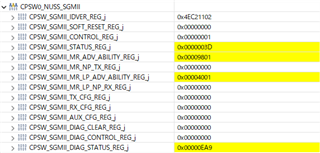

    -. Set DP83867 registers(mentioned in previous reply)
    The value of the SGMII registers (only MAC port 1 is enabled) is here:
    Junichi
  • Hi Junichi-san,
    From the register dump, the link is up for the MAC port (Bit 0 of CPSW_SGMII_STATUS_REG_j).
    Can you check the link status from BMSR register in Phy?
    Are you able to send any data across the link?
    Do you have any HLOS running on A72? If the HLOS running on A72 is also configuring the serdes (configuration differing from what you have done on R5), then serdes might also cause some issues for data transfer.
    Tanmay
  • Hello, Tanmay-san.
    BMSR register shows a link-up and 100Mbps communication works well.
    Our issue is that 1Gbps communication is not selected in auto-negotiation.
    Attached you can find the register dump for reference.
    A72 never accesses the SERDES.
    Junichi
