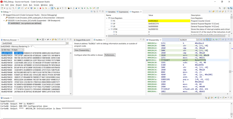

  • When I check with JTAG ROM Code is on the loop at address 0x2862c, TI Team please check on the same.

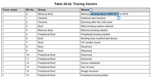

    I want to know whether micron (MTFC4GLWDM-4M AAT A ) eMMC is compatible with ROM code in RAW mode.
    Because ROM code of eMMC cannot read GP Header which is at 0x200 address of eMMC, But we found that it is able to read CHSETTINGS (In tracing vector CHSETTINGS found bit is set to 1).
    Tracing Vector:
                                    Addr                  :        Value
    Tracing vector 1:     4030CE40h        :      0x0010907F (20th bit of Tracing vector)
    Tracing vector 2:     4030CE44h        :      0x0000F000
    Tracing vector 3:     4030CE48h        :      0x00011000
    I have loaded TOC of 512 bytes at 0x00 address of eMMC as mentioned in AM335x TRMM. And at 0x200 GP header is present, followed by .bin file.
    Why AM335x cannot able to read GP Header, But able to detect CHESTTINGS, Is there any other settings I missed?

  • Which MMC port are you attempting to boot from?  The tracing vectors indicate you are attempting to boot from MMC0, which is not compatible with larger memories.  Please see section 26.1.8.5.2 of the TRM for more information.
    James

  • Hi James,
    In tracing vector 1 ,BIT 0 is also set which mean it is trying to boot from MMCSD1 or SPI0.
    MMC0 pins are not connected.
    We have connected eMMC to MMC1 as it is 4GB(MTFC4GLWDM-4M AAT A).
    SYSBOOT PINS are set to 11100
    so Booting device order: MMC1  >  MMC0  >  UART0  >  USB0
    I have also cross checked the SYSBOOT PINS  in CONTROL_MODULE_STATUS_REGISTER
    LCD_DATA[4:0] = 11100.
    CLARIFICATION:
    It cannot boot from MMC0 as it is not connected to any SD CARD or eMMC. We have only connected to MMC1 to the pins mentioned in TRMM for booting.
    QUERY:
    1.How MPU is detecting TOC when MMC0 is not connected?
    2. Will MPU not move to next booting device after trying to boot previous device( May be leading bit set for MMCSD0 Booting).

    Further I have run the bootloader through JTAG, It is running fine(I am able to see UART prints on console). I also cross checked the memory browser, the same .bin is running at address 0x402f0400.
