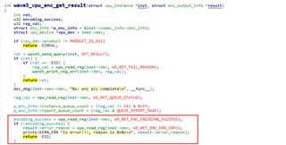

On our custom board we want to encode simultaneously on two device nodes. Our reserved cma memory is 1GB. The resolution encoded on /dev/video0 is 3840 * 3072. The resolution encoded on /dev/video1 is 3840 * 3240. But when encoding node video0, video1 cannot be encoded. We found an error in the following locations:
linux\drivers\media\platform\chips-media\wave5\wave5-hw.c
As shown in the red box in the figure, I added debugging printing, and the results are as follows:
Does it not support such a large resolution? If supported, how to solve it? Thank you very much!

  • Hi Alex,
    The device is able to handle a maximum resolution of 8192x8192 per encoder instance. However, is important to mention that the max resolution that is guaranteed real time performance is 4K60 per instance. Your encoding instances exceed this resolution so real time is NOT guaranteed.
    Encoder should still be achieved successfully. Could you share with me your use case? Are these camera inputs, or just using raw video files? If just raw video files, could you share these files with me?
    How are you encoding these videos? Gstreamer or another application? Lastly, which codec are you using for encoding (264 or 265)?
    Brandon
