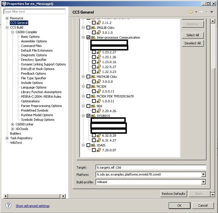

    You suggest to use IPC package, but when I add RTSC support on my project, in return having error, target is not supported.
    What is the ti.target for ti.platform.evmc6670?
    /F
  • That's just a check that's hardcoded into the cfg file (at least if you're using the example projects from IPC)
    If you look at the cfg file, you should see something like:
    switch (Program.platformName) {
        case "ti.sdo.ipc.examples.platforms.evm6670.core0":
            var nameList = ["CORE0", "CORE1", "CORE2", "CORE3"];
            break;
        case "ti.sdo.ipc.examples.platforms.evm6678.core0":
            var nameList = ["CORE0", "CORE1", "CORE2", "CORE3",
                            "CORE4", "CORE5", "CORE6", "CORE7"];
            break;
        default:
            throw("Platform " + Program.platformName + " not supported by this example");
            break;
    So you can work around the problem by switching to evm6670.core0, which should be the exact same except it includes the DDR3 region -- or just change the cfg file to not do the hardcoded check and just specify the "procNameList" yourself

  • After building example I get following error:
    Platform ti.platforms.evm6670 not supported by this example message_multicore.cfg /TMessageQ line 42 XDCTools Configuration Marker
    41:default:
    42:  throw("Platform " + Program.platformName + " not supported by this example");
    43: break;
    What might causing problem? As I asked earlier ti.target is unclear for me, I have tried different ones, but whenever I build same error: platform not supported by this example or code!
    /F
    See the "Platform" line? That is what you need to change and what I was talking about in my earlier post. ti.sdo.ipc.examples.platforms.evm6670.core0 should be an option since you have IPC included as a repository  (both 6678.core0 and 6670.core0 should be available. I just happen to be using 6678)
