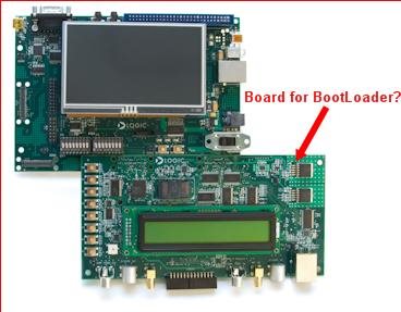

It's possible to execute the bootloader  without SD on the EVM TMDSEXPL138?
..... IF OK,  we need use the board xxx as showed bottom?
Than, it possible to use the  NAND FLASH MT29F4G08ABADAWP-IT:D for bootloader in the NAND flash SMT SOP socket

    1.     In order to  run  boot loader on Nand Memory we have to use the board in figure, where it's present the Nand flash SMT SOP Soket always showed in figure?
    2.    Last question, my costumer ask me it's  can use the Nand memory type MT29F4G08ABADAWP-IT
    The OMAP-L138 ROM bootloader does support several boot mode including NAND boot. Provided that you have setup the EVM with the correct DIP switch settings the ROM bootloader will start to boot from NAND. The NAND on the EVM is factory programmed so that you can boot from it. It contains the User bootloader (UBL) that will load U-Boot that will load the Linux kernel.
    EVM documentation (including DIP switch settings, ..etc) is available from the LogicPD page (you should be able to access it provided that you create an account):
    http://www.logicpd.com/products/development-kits/zoom-omap-l138-evm-development-kit#tabs-som-4
    - I can not answer specifically for MT29F4G08ABADAWP-IT but we specifiy the requirements for NAND support.
    Since you want to boot from NAND you need to check if the ROM bootloader does support the NAND you want to use. The below Twiki article should help:
    http://processors.wiki.ti.com/index.php/Davinci/Sitara/Integra_Nand_Boot_FAQ
    - Be aware that it might be difficult to source a given NAND device after some times. There are some specific comments about it on the above article.
    An alternative to NAND would be to use an alternative boot mode. Typically instead of using the NAND boot of the ROM botloader you could use a custom 2nd level bootloader code that boot from I2C/SPI. This 2nd level bootloader could then boot the system (U-boot, Kernel and file system) from your NAND device. As a starting point you could look at the UBL code and adapt it to your need.
    For alternative boot methods ee as well section aboout managed NAND on the above link too.
