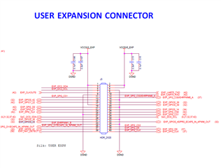

We are using linux 08.06.00.4.2, we need the user expansion I/O pins to be enabled
How can we enable the gpio pins in J3?

    I have looked at some of the GPIO pins from J3 connector , and those are directly connected to the SOC.

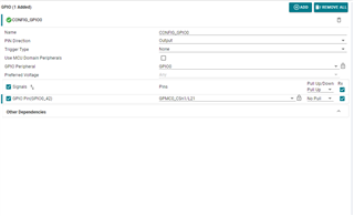

    Now, if you want to configure those GPIOs as input or output, you should enable them from CCS If those pins are controlling on R5F and M4F core.
    In the below image, I have configured GPIO0_42 as output and used it in my Application  , which is connected to 13th pin of J3.
    So, you also just follow the same procedure. Simply configure pin mode as per your requirements from CCS and compile and load the binary on your destination core.

    For GPIO0_42 on SK_AM62x, the device tree that needs to be modified is 'k3-am62x-sk-common.dtsi'. You can use the Sysconfig tool to generate the code needed for the device tree. It can be found at dev.ti.com > Configure pins and generate initialization code. Add a GPIO module, set it to use GPIO0 and add pin 42.
    Add the device tree code generated under '&main_pmx0' in 'k3-am62x-sk-common.dtsi'. Also add a reference to the GPIO module. A similar process can be seen in this thread: https://e2e.ti.com/support/processors-group/processors/f/processors-forum/1246530/am6412-gpio-write-operation-not-done
