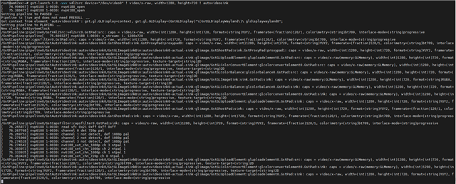

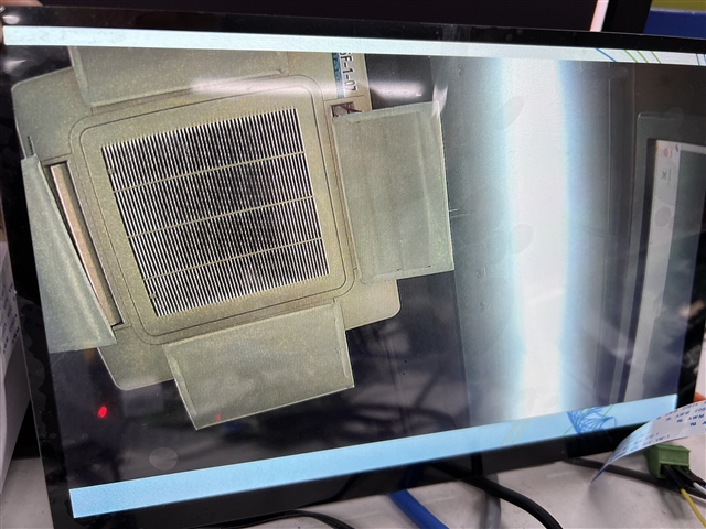

Our evaluation board has a CPU model AM6254, and it is connected to a MIPI CSI camera. We use the following command to capture camera data, and the camera data can be displayed correctly on the LCD:
  gst-launch-1.0 -vvv v4l2src device="/dev/video0" ! video/x-raw, width=1280, height=720 ! autovideosink
The display on the serial terminal is as follows:
The captured image is shown below:

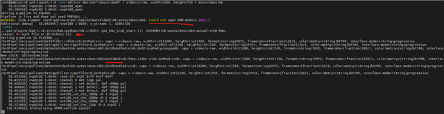

However, when we use a CPU model AM6234 with the evaluation board and connect it to a MIPI CSI camera, the LCD does not display any image. At the same time, the display on the serial terminal is as follows:
The lcd only display string "please wait ..."  and have no captured image , as we can see from the picture below:

    This may be a display issue. To rule out any camera capture issue, can you try to save the captured images to a file instead of streaming to a display?
    gst-launch-1.0 v4l2src num-buffers=50 device="/dev/video0" ! video/x-raw, width=1280, height=720 ! filesink location=cam-cap.yuv
    If this works for both AM6254 and AM6234, it means camera capture is fine and we can proceed to debug the display.
    Jianzhong
    As you mentioned earlier, there is no GPU on AM6234. However, your pipeline uses autovideosink and that uses waylandsink which has dependency on GPU. My recommendation would be to use kmssink instead.
    Krunal
