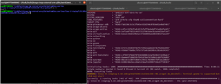

  • Hi Andreas,
    In addition, I'd like to know why I'm now getting the issue below after performing the configuration setup again and running MACHINE=am62axx-evm bitbake -k tisdk-base-image.
    Please guide me further to resolve.
    ~/tisdk/build$ MACHINE=am62axx-evm bitbake -k tisdk-base-image
    NOTE: Started PRServer with DBfile: /home/ubuntu/tisdk/build/cache/prserv.sqlite3, IP: 127.0.0.1, PORT: 46377, PID: 1670083
    Loading cache: 100% |####################################################| Time: 0:00:03
    Loaded 17408 entries from dependency cache.
    NOTE: Resolving any missing task queue dependencies

    NATIVELSBSTRING      = "ubuntu-20.04"
    TARGET_SYS           = "arm-linux-gnueabi"
    MACHINE              = "am62axx-evm-k3r5-hs-se"
    DISTRO               = "arago"
    DISTRO_VERSION       = "2021.09"
    TUNE_FEATURES        = "arm armv7a vfp thumb callconvention-hard"
    TARGET_FPU           = "hard"
    meta-processor-sdk   = "HEAD:fab130c5c3c2fb43c432d294c9783e92a4b67401"
    meta-arago-distro
    meta-arago-extras    = "HEAD:e4fcc247b2fadc457efaff8edabdf12a6b4fa4d1"
    meta-qt5             = "HEAD:5ef3a0ffd3324937252790266e2b2e64d33ef34f"
    meta-virtualization  = "HEAD:beea119eb529b4a11f266004aee8b548427aea39"
    meta-networking
    meta-python
    meta-oe
    meta-gnome
    meta-filesystems
    meta-multimedia      = "HEAD:87571345059f82fb7599e3aa82e6fdcfbd361098"
    meta-ti              = "HEAD:45bdaf7da0bc79fa73f1e01bb30b5c3b2eb34545"
    meta-arm
    meta-arm-toolchain   = "HEAD:c4f04f3fb66f8f4365b08b553af8206372e90a63"
    meta                 = "HEAD:daaee6fcb0d201f041678af433d8e1cd6f924d09"
    meta-sysrepo         = "HEAD:8bcc6151897c0e67c2931c78340477bf3a12d8cb"
    meta-jupyter         = "HEAD:82db248e2eca36e52cbeafe599b755dc87720383"
    WARNING: /home/ubuntu/tisdk/sources/meta-ti/recipes-kernel/linux/linux-ti-staging_5.10.bb:do_deploy is tainted from a forced run
    Initialising tasks: 100% |###############################################| Time: 0:00:15
    Sstate summary: Wanted 3 Found 1 Missed 2 Current 1713 (33% match, 99% complete)
    NOTE: Executing Tasks
    ERROR: linux-ti-staging-5.10.168+gitAUTOINC+2c23e6c538-r0b.arago5 do_deploy: Execution of '/home/ubuntu/tisdk/build/arago-tmp-external-arm-glibc/work/am62axx_evm-linux/linux-ti-staging/5.10.168+gitAUTOINC+2c23e6c538-r0b.arago5/temp/run.do_deploy.1670603' failed with exit code 1
    ERROR: Logfile of failure stored in: /home/ubuntu/tisdk/build/arago-tmp-external-arm-glibc/work/am62axx_evm-linux/linux-ti-staging/5.10.168+gitAUTOINC+2c23e6c538-r0b.arago5/temp/log.do_deploy.1670603
    Log data follows:
    | DEBUG: Executing python function sstate_task_prefunc
    | DEBUG: Python function sstate_task_prefunc finished
    | DEBUG: Executing python function package_get_auto_pr
    | DEBUG: Python function package_get_auto_pr finished
    | DEBUG: Executing python function extend_recipe_sysroot
    | NOTE: Direct dependencies are ['virtual:native:/home/ubuntu/tisdk/sources/oe-core/meta/recipes-kernel/dtc/dtc_1.6.0.bb:do_populate_sysroot', '/home/ubuntu/tisdk/sources/oe-core/meta/recipes-kernel/kmod/depmodwrapper-cross_1.0.bb:do_populate_sysroot', 'virtual:native:/home/ubuntu/tisdk/sources/oe-core/meta/recipes-devtools/bison/bison_3.5.4.bb:do_populate_sysroot', 'virtual:native:/home/ubuntu/tisdk/sources/oe-core/meta/recipes-devtools/patch/patch_2.7.6.bb:do_populate_sysroot', '/home/ubuntu/tisdk/sources/meta-arm/meta-arm-toolchain/recipes-devtools/external-arm-toolchain/external-arm-toolchain.bb:do_populate_sysroot', 'virtual:native:/home/ubuntu/tisdk/sources/oe-core/meta/recipes-devtools/pseudo/pseudo_git.bb:do_populate_sysroot', '/home/ubuntu/tisdk/sources/oe-core/meta/recipes-devtools/quilt/quilt-native_0.66.bb:do_populate_sysroot', 'virtual:native:/home/ubuntu/tisdk/sources/oe-core/meta/recipes-bsp/u-boot/u-boot-tools_2020.01.bb:do_populate_sysroot', '/home/ubuntu/tisdk/sources/meta-ti/recipes-kernel/linux/linux-ti-staging_5.10.bb:do_populate_sysroot', '/home/ubuntu/tisdk/sources/oe-core/meta/recipes-kernel/kmod/kmod-native_git.bb:do_populate_sysroot', 'virtual:native:/home/ubuntu/tisdk/sources/oe-core/meta/recipes-support/gmp/gmp_6.2.0.bb:do_populate_sysroot', 'virtual:native:/home/ubuntu/tisdk/sources/oe-core/meta/recipes-support/lzop/lzop_1.04.bb:do_populate_sysroot', 'virtual:native:/home/ubuntu/tisdk/sources/oe-core/meta/recipes-support/libmpc/libmpc_1.1.0.bb:do_populate_sysroot', 'virtual:native:/home/ubuntu/tisdk/sources/oe-core/meta/recipes-extended/xz/xz_5.2.4.bb:do_populate_sysroot', 'virtual:native:/home/ubuntu/tisdk/sources/oe-core/meta/recipes-extended/bc/bc_1.07.1.bb:do_populate_sysroot']
    | NOTE: Installed into sysroot: []
    | NOTE: Skipping as already exists in sysroot: ['dtc-native', 'depmodwrapper-cross', 'bison-native', 'patch-native', 'external-arm-toolchain', 'pseudo-native', 'quilt-native', 'u-boot-tools-native', 'linux-ti-staging', 'kmod-native', 'gmp-native', 'lzop-native', 'libmpc-native', 'xz-native', 'bc-native', 'python3-setuptools-native', 'swig-native', 'openssl-native', 'ti-rtos-firmware', 'unzip-native', 'kern-tools-native', 'optee-os', 'flex-native', 'python3-native', 'trusted-firmware-a', 'libtool-native', 'gnu-config-native', 'pkgconfig-native', 'zlib-native', 'autoconf-native', 'automake-native', 'gtk-doc-native', 'texinfo-dummy-native', 'mpfr-native', 'readline-native', 'gettext-minimal-native', 'attr-native', 'lzo-native', 'libpcre-native', 'opkg-utils', 'm4-native', 'libtirpc-native', 'sqlite3-native', 'libnsl2-native', 'libffi-native', 'gdbm-native', 'util-linux-native', 'bzip2-native', 'ncurses-native', 'libcap-ng-native', 'libpcre2-native']
    | DEBUG: Python function extend_recipe_sysroot finished
    | DEBUG: Executing shell function do_deploy
    | install: cannot stat 'arch/arm64/boot/Image': No such file or directory
    | WARNING: exit code 1 from a shell command.
    | ERROR: Execution of '/home/ubuntu/tisdk/build/arago-tmp-external-arm-glibc/work/am62axx_evm-linux/linux-ti-staging/5.10.168+gitAUTOINC+2c23e6c538-r0b.arago5/temp/run.do_deploy.1670603' failed with exit code 1
    ERROR: Task (/home/ubuntu/tisdk/sources/meta-ti/recipes-kernel/linux/linux-ti-staging_5.10.bb:do_deploy) failed with exit code '1'
    NOTE: Tasks Summary: Attempted 5864 tasks of which 5863 didn't need to be rerun and 1 failed.
    NOTE: Writing buildhistory
    NOTE: Writing buildhistory took: 5 seconds
    Summary: 1 task failed:
    Summary: There was 1 WARNING message shown.
    Summary: There was 1 ERROR message shown, returning a non-zero exit code.
    Thanks, Manoj.
