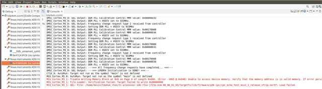

  • Hi Parth,
    Thanks for your information. I will suggest customer use PDK build in the future.
    I have tested running the "ipc_echo_test_mcu1_1_release_strip.xer5f" which is built in our default SDK8.6 at RTOS_SDK/targetfs/lib/firmware/pdk-ipc/ folder. After a Happy Debugging shown on the CCS12.0, I connected the MCU1_1 target and then load this default file to MCU1_1, the same error shows below.
    If I load other default mcu1_1 xer5f files like the ones located in SBL such as sbl_baremental_boot_test_j721e_evm_mcu1_1TestApp_release.xer5f, there is no such errors, so may I know if there is any requirement to load mcu1_1 properly on CCS?
    Kind Regards,
    Kevin
  • Hi Kevin,
    I am able to reproduce this issue on my end, I can see the similar behavior as you. For some reason, for MCU1_1 ACTM > 2KB is not accessible, due to which we are not able to load via CCS. I am checking this further, will get back with details on this.
