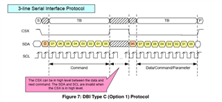

Dear TI team,
We are currently seeking a Display device for our application. As the AM64xx series lacks a display controller, our approach involves utilizing SPI for communication with an external display device. Among the potential options, we have narrowed down to a few that offer 3 Line SPI support. However, it's worth noting that the initial communication frame requires 9 bits of data. Our main concern is whether the AM6442 SPI & driver for Linux can accommodate this particular data transfer configuration. I have observed that the data buffer support is available for 8, 16, and 32 bits. Does this mean that the data size granularity for data transfers is based on bytes?
The display device (WF35UTYAIDNN0) is equipped with the ILI9488 controller, and the provided sample transfer operation illustrates the usage in 3-line SPI mode. I would appreciate your advice on how to proceed.

    The diagram you attached in the above message - is that for the LCD?
    Sreenivasa
  • Thanks
    Do you have a setup to do some quick check?
    No, we need to decide based on the support by AM64xx. There are only limited options for displays with SPI interface. From the above responses what I understood is, it is capable for 9-bit transmission, but not the driver right?
    Yes, The target device SPI communication frame expects 9-bit transmission. One bit for Data or command identification and 8 bit actual data. ILI9488 is the controller

    Yes, the target device SPI communication frame expects 9-bit transmission. One bit for Data or command identification and 8 bit actual data. ILI9488 is the controller
    Thank you. Any reason the pins are named SDA and SCL - these are names used for I2C.interface.
    Sreenivasa
  • Thank you. Any reason the pins are named SDA and SCL - these are names used for I2C.interface.
     May be they have taken it as Serial Data (SDA) as a common for input and output instead MOSI and MISO
