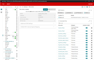

Hi
May I have some questions about AM64x PRUs?
My customer is developing AM6442 with MCU+SDK 8.06.
Question1
I think AM64 PRU must wake-uped by R5F, A53,... ARM core.
Is there any way wake up from SBL code?
Question2
In SDK example, PRU code is load by R5F core.
Could not we program looks like another ARM core project?
Could not we make PRU project looks like R5F core project?
Question3
In SDK example for pru, I think there are only written in assembler.
Is there any plan that relese C/C++ base PRU example?
Question4
Is there anything document/guide How to debugg PRU code in CCS?
If PRU code loaded by R5F, I think we could not debugg especially PRU core.
