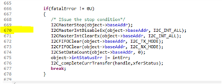

    I have looked at the code, and it seems to be okay.
    In the issue scenario (Above scenario) , SOC sends stop. So, first we need to check why SOC sends a stop.
    You can put a breakpoint in the below function at lines 670 and 725.
    I2C_hwiFxnMaster
    And see why SOC is sending a STOP pulse to sensor .
    S.Anil.
