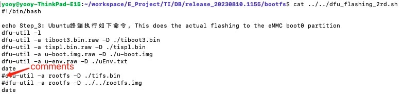

    Which firmware are you loading for the R5F & C7X? Are you loading the vision_apps firmware? If yes then do you have the corresponding dtbo for vision_apps loaded?
    - Keerthy

  • Yes.  Is it the file "k3-j721s2-vision-apps.dtbo" you mentioned ?  This file is location in rootfs path(/boot/k3-j721s2-vision-apps.dtbo)
    Is this loaded at U-Boot? How are you loading the above dtbo file? Are you using the U-Boot to load that?
    - Keerthy

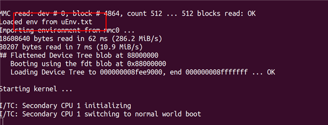

  • I think it is loaded at linux kernel. Because the failure log is from kernel log as below.
    [ 5.220510] remoteproc remoteproc3: Booting fw image j721s2-main-r5f0_0-fw, size 719944
    [ 5.225802] remoteproc remoteproc0: Booting fw image j721s2-c71_0-fw, size 14815296
    [ 5.240177] m_can_platform 2681000.can: m_can device registered (irq=41, version=32)
    [ 5.253289] remoteproc remoteproc3: bad phdr da 0xa2f2a000 mem 0x1bc000
    [ 5.254790] remoteproc remoteproc0: unsupported resource 65538
    [ 5.260535] remoteproc remoteproc3: Failed to load program segments: -22
    [ 5.272853] remoteproc remoteproc0: bad phdr da 0xb0100000 mem 0x98
    [ 5.285827] remoteproc remoteproc0: Failed to load program segments: -22
    [ 5.362533] remoteproc remoteproc2: Booting fw image j721s2-c71_1-fw, size 9760696
    [ 5.420122] remoteproc remoteproc2: Failed to load program segments: -22

    [14:42:11:322] => setenv bootpart 0
    [14:43:02:120] => boot
    [14:43:05:585] switch to partitions #0, OK
    [14:43:05:585] mmc0(part 0) is current device
    [14:43:05:792] SD/MMC found on device 0
    [14:43:05:792] Failed to load 'boot.scr'
    [14:43:05:808] ** Unrecognized filesystem type **
    [14:43:05:872] 19964416 bytes read in 63 ms (302.2 MiB/s)
    [14:43:05:912] 84991 bytes read in 6 ms (13.5 MiB/s)
    [14:43:05:912] ## Flattened Device Tree blob at 88000000
    [14:43:05:912]    Booting using the fdt blob at 0x88000000
    [14:43:05:912]    Loading Device Tree to 000000008fee8000, end 000000008fffffff ... OK
    [14:43:05:912]
    [14:43:05:912] Starting kernel ...
    [14:43:05:912]

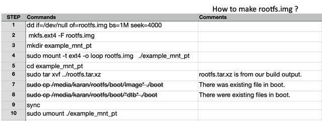

  • Hi Nikhil,
    Could you please share the exact steps you are following for USB-DFU flashing?
    Yes, please help review our flashing steps as below.
    Are you using tiny rootfs or the default rootfs?
    No, As above showing, we are flashing rootfs.img which is made by rootfs.tar.xz that is from our build output.
    If the default rootfs, were you able to transfer 2.2GB of this via dfu?
    Yes, It looks good, DFU does not limit the length of the file. the length of our rootfs.img is around 4.0G.
    Are you trying this on your board or on EVM?
    Yes.
    Note : Additionally to copy uEnv.txt please write the below command
    BTW,  We did not find the step to flash uEnv.txt at section "5.1.3.1 Flashing Instructions" in Doc <TDA4 Flashing Techniques.pdf> . But I noticed you provided one command to flash uEnv.txt by coping SDcard  to eMMC. I suspect this problem could be caused by lacking of uEnv.txt. Could you provide the command to flash to uEnv.txt into eMMC by DFU ?
    BR
    Liuli

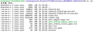

    When doing the above step, you could do
    sudo dfu-util -a u-env.raw -D <PATH_TO_BIN>/uEnv.txt
    Please note that the uEnv.txt should have k3-j7xxx-vision-apps.dtbo mentioned under name_overlays.
    Nikhil
  • Hi Nikhil,
    Thanks, We tried this command to flash uEnv.txt as below. But it looks not work. We also check the uEnv.txt, it is including the file "
    k3-j721s2-vision-apps.dtbo".
    Is there anything else I missed ?
    BR
    Liuli
    Do you mean the command did not work or you are facing the same issue while booting the eMMC?
    If it is eMMC, Could you send me the logs again from eMMC after this change?
    Also, I would like to understand why are you putting tifs.bin in rootfs?
    Could you try without this line?
    Could you also confirm that the rootfs from which the rootfs.img is made, has been tested on SD card boot mode and you are able to run vision_apps there? Just to confirm that you have all the required firmwares required for the code.
    Nikhil
  • Hi Nikhil,
    Yes, We are blocked in the same issue.
    Ok, Here is the log  after this change. Please help check it.
    As you can see. actually we did not use the command due to it is comment.
    Yes, We confirmed all firmwares required have been in rootfs. Because we have tested that rootfs on sdcard boot mode.
    BTW, I noticed these files in bootfs as below have flashed into eMMC.
    tiboot3.bin, tispl.bin, u-boot.img,  uEnv.txt
    But the other files in bootfs, such as  tiboot3-j721s2-hs-fs-evm.bin,  tiboot3-j721s2-gp-evm.bin,  etc
    Do I need to flash the other files into eMMC by DFU also? if it is necessary, how to flash them by DFU ?
    BR
    Liuli
  • HI Nikhil,
    Is there any advice about this issue? The uboot looks still can not find the file "uEnv.txt"  after we push it into eMMC boot by command as below.

  • HI Nikhil,
    sudo dfu-util -a u-env.raw -D  ./uEnv.txt
  • Hi Liu
    In boot 0 partiton you cant use fatload that is why you are facing issue
    19964416 bytes read in 62 ms (307.1 MiB/s)
    84991 bytes read in 5 ms (16.2 MiB/s)
    as it is unable to do the fatload for getting the uenv.
    Please use emmc uda partition if want to use uEnv.txt
    If you still want to use boot 0 you can do so by modifying the following command
    set loadbootenv "mmc read ${loadaddr} 0x1300 0x200"
    set importbootenv "echo Importing environment from mmc${mmcdev} ...; env import -t ${loadaddr} 0x200"
    run importbootenv
    assuming the offset and the size are 0x1300 and 0x200.in the above command we are doing raw read instead of fatload
    then if you run boot you will be able to boot
    Diwakar
