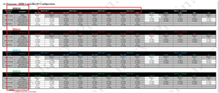

    I see there are DDRSS0,1,2,3 modules and Data Lane 0,1,2,3 in the 0.10.0 version new tool. As we use TDA4VM chips. So do we just need to configurate DDRSS0 and Data Lane 0? How to deal with the others? Just don't care about them, or fill null values,or other values to them?
