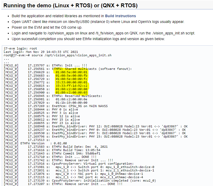

    Once you prepare SPL boot flow setup, visions apps scripts will map MCU2_0 binary (ethfw + vision apps)  to Main R5F core 0.
    If you are loading server image from ethfw folder then it will be ethfw alone, does not integrate vision applications into it.
    If you are loading mcu2_0 image from visions_apps then it will be with ethfw and vision applications.
    If you follow steps-1, 3 then it will only map firmware image to R5F core.
    https://software-dl.ti.com/jacinto7/esd/processor-sdk-rtos-jacinto7/latest/exports/docs/vision_apps/docs/user_guide/RUN_INSTRUCTIONS.html#run_steps_linux

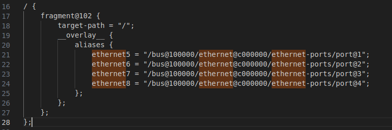

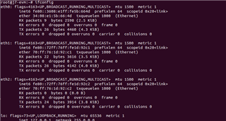

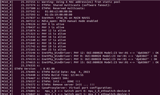

    All the 8 ports are alive however, I can't see their MAC.
    Default EthFw application will enable 2 MAC only Ports and rest all are under switch ports, and it will create one virtual switch interface (eth1) and virtual MAC port interface (eth2) on A72 Linux.
    From eth1 you can send broadcast data from all switch ports, and from eth2 you can send data from Port-1 (default MAC only port mapped to A72).
    From your logs screen, Ethernet application result is correct as per configuration.
    Please refer to EthFw user-guide for more details.

    eth0: flags=4163<UP,BROADCAST,RUNNING,MULTICAST> mtu 1500 metric 1
    inet6 fe80::3608:e1ff:fe5b:664d prefixlen 64 scopeid 0x20<link>
    ether 34:08:e1:5b:66:4d txqueuelen 1000 (Ethernet)
    RX packets 19 bytes 5291 (5.1 KiB)
    RX errors 0 dropped 0 overruns 0 frame 0
    TX packets 28 bytes 4860 (4.7 KiB)
    TX errors 0 dropped 0 overruns 0 carrier 0 collisions 0
    eth1: flags=4163<UP,BROADCAST,RUNNING,MULTICAST> mtu 1500 metric 1
    inet6 fe80::72ff:76ff:fe1d:92c1 prefixlen 64 scopeid 0x20<link>
    ether 70:ff:76:1d:92:c1 txqueuelen 1000 (Ethernet)
    RX packets 44 bytes 6434 (6.2 KiB)
    TX packets 27 bytes 4342 (4.2 KiB)
    eth2: flags=4163<UP,BROADCAST,RUNNING,MULTICAST> mtu 1500 metric 1
    inet6 fe80::72ff:76ff:fe1d:92c2 prefixlen 64 scopeid 0x20<link>
    ether 70:ff:76:1d:92:c2 txqueuelen 1000 (Ethernet)
    RX packets 39 bytes 8257 (8.0 KiB)
    TX packets 26 bytes 4184 (4.0 KiB)

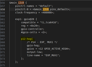

  • Hi Sudheer,

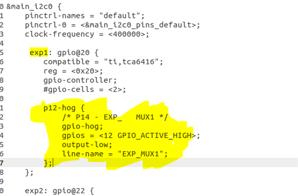

    I found this information from the documentation.
    How can I set to low. This will activate mux.
    How can I update the device tree? Can you provide a sample?
    Please refer to the below code/images for enabling GESI CAN ports in Linux from device tress file. (k3-j721e-common-proc-board.dts file to be updated with below info).
    1. Add pin hog for selection of CAN pins from MUX.
    2. Enable MCAN Nodes on GESI and add transceiver node as per below in  k3-j721e-common-proc-board.dts file.

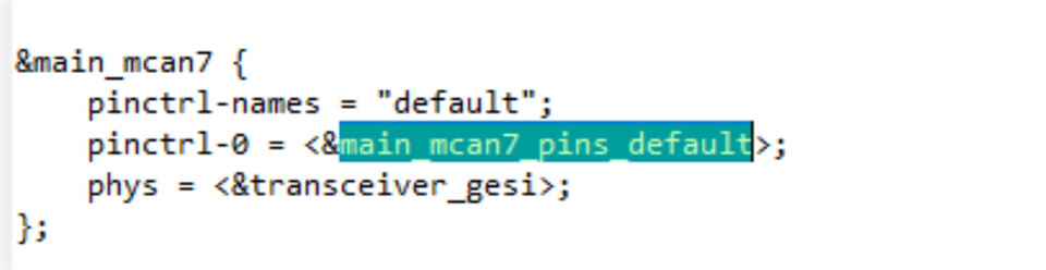

    &main_mcan7 {
    	pinctrl-names = "default";
    	pinctrl-0 = <&main_mcan7pins_default>;
    	phys = <&transceiver_gesi>;

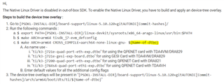

    Also I want to enable all the ethernet ports as MAC ports so I can transfer the data externally through them.
    Using EthFw we can't enable all ports as MAC ports due to the resource limitation like UDMA Tx channels, Rx flows, MAC Address, please refer to EthFw user guide for more details about the resources on remote client cores.
    You can enable all ports as MAC only ports from linux by using native Linux driver for CPSW9g. Please refer to the FAQ [How to move to Native Linux driver] and run CPSW9g with Native Linux driver.
    For more detail about features supported with Native Linux driver and how to use, please refer to SDK Documentation of Native Driver.

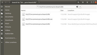

    After making/adding above changes build dtbs and use the "k3-j721e-common-proc-board.dtb".
    You have to download Linux SDK, and make changes mentioned in above note in k3-j721e-common-proc-board.dts file in "<Linux SDK>/board-support/linux-x.x.x/arch/arm64/boot/dts/ti/".
    Build Linux dts using following command from "<Linux SDK>".
    # make linux-dtbs
    For more details refer to Linux SDK documentation.
    How can I build it? From which directory to I need to copy the file and to which location in RTOS directory.
    After you build dts files, you will see generated binary in "<Linux SDK>/board-support/linux-x.x.x/arch/arm64/boot/dts/ti/" directory.
    You have to copy this updated binary to boot media "rootfs/boot/" directory and boot setup.

  • Build Linux dts using following command from "<Linux SDK>".
    # make linux-dtbs
    After running this command the file k3-j721e-common-proc-board.dtb remains same and there is no change in it. Do I need to change something in the config or make file?
    No need of any configuration, After adding CNA channel nodes and transceiver node if you build device tree files "k3-j721e-common-proc-board.dtb"  will be generated again with CAN nodes, you can check the last updated date it should be present date and time.
    Note:
    You should use J721E Linux SDK for this.
    I have enabled CAN4 channel and tested at my side from A72 (Linux), working as expected.
    Sorry, there is a small mistake in MCAN7 node.
    Pin control should be "&main_mcan7_pins_default", please refer to below.
    Sudheer
  • Hi Sudheer,
    Thank you for the help. I have managed to test all the CAN channels and they working fine. CAN issue is resolved for now.
    I want to enable all the ethernet ports as MAC ports in Linux A72.
    Steps I followed.
    1. RTOS Vision apps loaded.
    2. Updated dtb files for CAN.
    3. Run vision apps_init.sh file.
    4. run ifconfig -a
    I can only see share multicast ethernet ports that are used for A72 to R5f. However in the vision_apps/ethfw demo application the results looks like this
    How can I enable all the ports as MAC only? I read the documentation for enable as MAC only but its little confusing for me. I want to deploy vision_apps that is in the rtos directory and enable all the ports as MAC only so I can see all of them as shown above and also from ifconfig -a.
    My results looks like this.
    As pointed above we can't enable all ports as MAC Only ports using EthFW.
    We have to use Linux native driver for CPSWnG for enabling native Linux driver please refer to FAQ pointed above.
    As you are using vision apps based rtos application by default EthFw will be part of vision application , you have to disable it from vision apps for native Linux driver usage.
    Follow below steps for disabling EthFw from vision apps.
    Disable EthFw build flag from vision_apps/vision_apps_build_flags.mak as BUILD_ENABLE_ETHFW?= no and do a clean rebuild of vision_apps.
    After preparing the media card with above then apply device tree overlay for CPSWnG Native Linux driver as pointed in FAQ.
    Sudheer

    Why I can't see all the MAC addresses for the ethernet ports when I am running vision_apps_init.sh
    If you can have a look into the picture from vision apps
    Here I have marker in yellow.
    However, when I am running the same application. I can only see 2 MAC address.
    [MCU2_0] 17.221804 s: ETHFW: Init ... !!!
    [MCU2_0] 17.226913 s: Warning: Using 6 MAC address(es) from static pool
    [MCU2_0] 17.227028 s: ETHFW: Shared multicasts (software fanout):
    [MCU2_0] 17.227152 s: ETHFW: Reserved multicasts:
    [MCU2_0] 17.227193 s: 01:80:c2:00:00:0e
    [MCU2_0] 17.227240 s: 01:1b:19:00:00:00
    [MCU2_0] 17.227484 s: EnetMcm: CPSW_9G on MAIN NAVSS
    [MCU2_0] 17.236795 s: Mdio_open: MDIO manual mode enabled
    [MCU2_0] 17.239715 s: PHY 0 is alive
    [MCU2_0] 17.240020 s: PHY 3 is alive
    [MCU2_0] 17.240655 s: PHY 12 is alive
    [MCU2_0] 17.240902 s: PHY 15 is alive
    [MCU2_0] 17.241007 s: PHY 16 is alive
    [MCU2_0] 17.241113 s: PHY 17 is alive
    [MCU2_0] 17.241214 s: PHY 18 is alive
    [MCU2_0] 17.241315 s: PHY 19 is alive
    [MCU2_0] 17.241614 s: PHY 23 is alive
    Maybe I can explain my problem little bit. I am using vision_apps and want to send/receive data to multiple ethernet ports. For that I need separate IP for each port which I can easily set by assigning a static IP in the network file. I am not bound to use RTOS or LINUX. However, I am bound to deploy vision_apps. What is the best possible solution?
    Abdul Rehman
    Vision Apps integrates EthFw and running on MCU2_0 (RTOS).
    EthFw configures two ports as MAC only Ports (Port-1 mapped to A72, Port-4 mapped to MCU2_1) and rest all are part of Switch port.
    MAC address assign will be each interface not for MAC port and by default it will map one MAC only Port to A72 and one Switch interface to A72 so, 2 MAC address will be used by A72.
    Similarly one MAC port mapped to MCU2_1 client and one switch port mapped to MCU2_1 so, 2 MAC address will be used by MCU2_1.
    Internal Switch port on MCU2_0 will use one MAC Address.
    For switch interface you can communicate to the device connected any of switch ports (as per above Port-2,3,5,6,7,8 are switch ports and 1,4 are MAC only ports).
    If you want to configure all ports as MAC only, you have to disable switch ports and map the ports to any of client that needs more resources than reserved in EthFw.
    So, suggested to go for Native Linux driver approach by default Linux driver treats each port as individually MAC only port and you can see 8 interfaces from ifconfig -a command on A72.

    As you are using TDA4VM and GESI card, you can use below command to build device tree overlay.
    make ARCH=arm64 CROSS_COMPILE=aarch64-none-linux-gnu- ti/k3-j721e-gesi-exp-board.dtbo
    It will provide access to 4 ports on GESI card for other 4 Ports on Quad Enet card enable "ti/k3-j721e-quad-port-eth-exp.dtbo" as well

  • Hi Sudheer,
    I have managed to load the dtbo files but it still only enable 4 ports on gesi board.
    root@j7-evm:/opt/vision_apps# ifconfig |grep eth
    ether 02:42:dd:2f:6a:a6 txqueuelen 0 (Ethernet)
    ether 70:ff:76:1f:0a:f4 txqueuelen 1000 (Ethernet)
    ether 70:ff:76:1f:0a:f5 txqueuelen 1000 (Ethernet)
    eth3: flags=4163<UP,BROADCAST,RUNNING,MULTICAST> mtu 1500 metric 1
    ether 70:ff:76:1f:0a:f6 txqueuelen 1000 (Ethernet)
    eth4: flags=4163<UP,BROADCAST,RUNNING,MULTICAST> mtu 1500 metric 1
    ether 70:ff:76:1f:0a:f7 txqueuelen 1000 (Ethernet)

    I have changed the following in dts files.
    k3-j721e-gesi-exp-board.dts
    Changed
    Do I have to change this also?
    Are there any other changes?
    Abdul Rehman
    Use same numbers for ethernetX and port@X in above.
    You have to change Pin Mux as per your Board and port number as required.
    If your are using J721E EVM, you have make changes in both GESI and QUAD expansion device tress files as per below.
    GESI overlay file:
    1. Enable Port numbers 1,3,4,8 in RGMII Mode.
    2. Select RGMII Pin mux also as per port numbers.
    3. Remove disabling of other CPSW Ports, as you want to enable all 8 Ports.
    QUAD overlay files:
    1. Enable Port numbers 2,5,6,7 in QSGMII Mode (default Port-2 is Main Node and rest of all are sub modes in QSGMII)
    2. Remove disabling of other CPSW ports.
    Use CPSW Port numbers also as pointed above specific to overlay file.
    Build both overlays and use generated device tree binaries and update uEnv.txt file with overlay file names and boot Board.

    GESI:
    fragment@102 {
    target-path = "/";
    __overlay__ {
    aliases {
    ethernet5 = "/bus@100000/ethernet@c000000/ethernet-ports/port@1";
    ethernet6 = "/bus@100000/ethernet@c000000/ethernet-ports/port@3";
    ethernet7 = "/bus@100000/ethernet@c000000/ethernet-ports/port@4";
    ethernet8 = "/bus@100000/ethernet@c000000/ethernet-ports/port@8";
    &cpsw0 {

    Quad port:
    fragment@102 {
    target-path = "/";
    __overlay__ {
    aliases {
    ethernet2 = "/bus@100000/ethernet@c000000/ethernet-ports/port@2";
    ethernet5 = "/bus@100000/ethernet@c000000/ethernet-ports/port@5";
    ethernet6 = "/bus@100000/ethernet@c000000/ethernet-ports/port@6";
    ethernet7 = "/bus@100000/ethernet@c000000/ethernet-ports/port@7";

    Is it correct? It seems like there is a clast for 2 ports in gesi and quad eth. I bold both of them. Please let me know if it is correct.
    Abdul Rehman
    As I have pointed above you have to update the Pin Mux for RGMII Ports-1,3,4,8
    &rgmii1_pins_default
    &rgmii2_pins_default
    &rgmii3_pins_default
    &rgmii4_pins_default>;
    Instead of RGMII2 you have to add Pin Mux for Port-8 and reference from above.
    Also, PHY nodes "cpsw9g_phy3" use port numbers as per Ports mapped for the overlay (as pointed above).
    Note:
    Please use "cpsw9g_mdio" once and merge the content of both files under this mdio node.
    It would be better to use single overlay file and merge the content of both files into single file.
    Sudheer

    &exp1 {
    	p15-hog {
    		/* P15 - EXP_MUX2 */
    		gpio-hog;
    		gpios = <13 GPIO_ACTIVE_HIGH>;
    		output-high;
    		line-name = "EXP_MUX2";
    	p16-hog {
    		/* P16 - EXP_MUX3 */
    		gpio-hog;
    		gpios = <14 GPIO_ACTIVE_HIGH>;
    		output-high;
    		line-name = "EXP_MUX3";

    	fragment@102 {
    		target-path = "/";
    		__overlay__ {
    			aliases {

    Abdul Rehman
    I have changed the files. Please have a look at the files and it would be great if you can do the necessary changes.
    Please refer to the FAQ [How to Move to Native Linux Driver], where we have added device tree file for enabling 8 Ports in TDAVM.
    Sudheer
