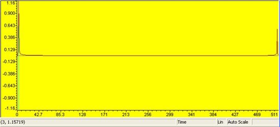

I am trying to implement FFT algorithm for Real Input disucssed on wiki page given below.
http://processors.wiki.ti.com/index.php/Efficient_FFT_Computation_of_Real_Input
But I am not getting the right result, it has 3 peaks which can be observed in the figure given below.
Moreover, FFT magnitude is not showing the right amplitude as of input signal which is 1.25V. I will really appreciate if some one help me out here.
Regards.

  • Tariq,
    Your screenshot looks "almost" correct for a sinusoid input signal.  The biggest problem is the spike in the middle of the buffer.  I have not seen an artifact like this in my tests.  Are you using the source code example from the real FFT wiki page?
    Based on the screenshot, I am guessing that you have a 1024-sample data buffer and calculate a 512-point FFT using the DSPLIB and the technique described on the wiki.  Is that correct?

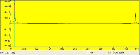

    I followed some previous posts related to this FFT algorithm and set the sizes of different buffer according to that post . I am still confused lillte bit.
    Do you mean the size of both input and output buffer of FFT should be N ?
    I modified the size of output buffer as shown below and computed N/2 magnitude values which can be seen in the graph given below.
    float pRFFT_In[N]; // Input Buffer
    float pRFFT_Out[N]; // Output Buffer
    float pTemp[N];
    Why the magnitude of both the peaks are not same ?
    Hope to get your reply soon.

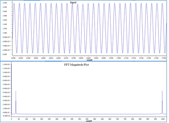

  • Tariq,
    I'm glad that we got rid of that "glitch" in the middle of your magnitude buffer.  Regarding the difference in magnitude between the two peaks, I think this is a normal consequence of the FFT algorithm.  Since the FFT represents a sampled form of the frequency domain, it's possible to "miss" strong narrow peaks.  You can address this by computing the FFT with a higher resolution (i.e. higher N).  One way to do this is zero-pad your input signal.
    For example, your input buffer could contain 1024 input values followed by 1024 zero values.  Then, you could compute a 1024-point real FFT using that 2048-element buffer.  The magnitude in that result should more closely match the ideal DFT you expect to see.
    Hope this helps.

  • Joe,
    I did computed 2048 point FFT but still the magnitude of both peaks are different.
    Can you please comment on the size of different buffers, I just want to make sure I am using the right size of different buffers.

  • Tariq,
    Your buffer sizes appear correct for a 512-point (i.e. N/2-point) FFT computation.  Assuming your input signal is 1024 samples in length and you don't want to pad it to get more resolution in the frequency domain, this is correct.
    When calculating magnitude, I believe that you should normalize by N / 2 since that is technically the length of the FFT that you calculated.
  • Joe,
    Few question aries here by looking at the graph.
    Sampling frequency which I am using is 351.56 KHz. If N/2 is the length of FFT and N is 1024 in my case then frequency resolution will be 351.56 KHz/512 = 686.64 Hz which should give a peak for 1 KHz sine wave at 2nd sample. But you can see in the picture that peak rises at 4th sample which seems true if frequency resolution has been calculated using N = 1024.
    Moreover, I divided the FFT magnitude by N which gives almost the same magnitude as of iput signal. If it was N/2 It will not give the right magnitude.
    Another surprising thing is that, FFT magnitude window shows frequencies from 0  to Fs when N/2 Point FFT is considered for calculating freq. resolution (512 FFT Point*686.64 Hz = 351.56 KHz). Otherwise it shows only half of Fs (512*343.23 Hz = 175.78 KHz).
    Above 2 calculations seem OK when considering N point FFT but not the last one . These results are contradictory in nature and I am not satisfied with the result.

  • Tariq,
    Thanks for providing us your input data to the code. I took your input data and plugged the data into the Real FFT code that is distributed on the wiki page. Here is my observation.
    • There is no 512th sample in the Magnitude plot as you have mentioned in earlier post.
    • There is a peak at 0th sample(DC) and at 30th and the 994th sample (corresponding to the 10Khz sine wave)
    Please refer to the output graph as shown below.
    Based on these results,I am pretty sure that the code does not have any bugs that is causing the 512th sample that you are observing. Can you tell me if the code you have implemented is it cache based implementation. If it is a cache based implementation, you may want to manage the cache for input buffers and output buffers appropriately. One important care about while invalidating your cache is that the FFT function in the DSPLIB performs inplace processing of data so treat the input buffer as an input and output buffer.
    Rahul
