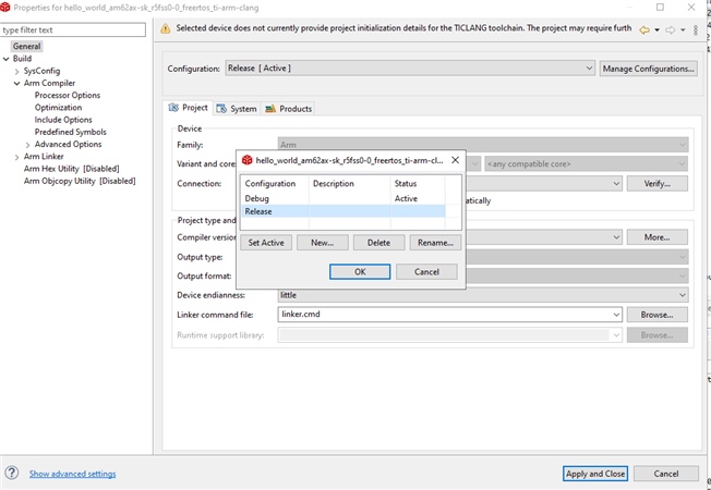

Hi Veerapandiyan,
Do you mean to say that you want to build the application and load the .out file onto the respective core, but all of this in release mode?
Also can you confirm if you are changing the selection in the following window ?
I reached the window by right clicking on the project in CCS and selecting Show Build Settings..
Please confirm on the above.
Vaibhav

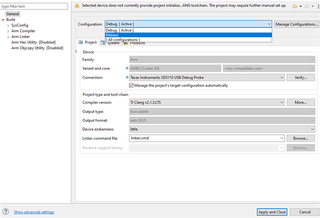

Hi Veerapandiyan,
In CCS, when you open build settings for a particular project, by default you see that Debug [ Active ] is written.
To change it properly, you need to select Manage Configurations..
In the new window pop up, simply select Release and select the option as Set Active.
Please check the below attachment for the same.
This should work, as it worked in my case.
Vaibhav
Hi Vaibhav
I changed Release mode(set active). same issue how to solve.
Thanks Regards,
Veerapandiyan V.

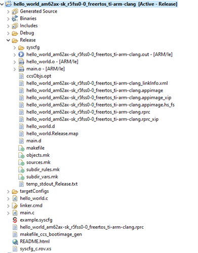

Hi Veerapandiyan,
After you hit Apply and close, that should be enough.
At this point your application configuration should be set to Release.
Can you please check and confirm again.
Essentially after building, you can load the .out file mentioned in the Release Directory.
Please see the attachment below.
Vaibhav
Hi Vaibhav,
I seeing Release folder show .out,.appimage file is there i attach the screen shot
Thanks Regards,
Veerapandiyan V.
Hi Veerapandiyan,
After building the project in Release Mode. Load the out file onto the respective core.
I just ran a simple hello world application.
Works like a charm for me.
Vaibhav
