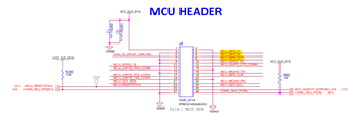

    To connect to the external AFE board, I want to use the MCSPI0 of the mcu header pins.
    So, if you could please tell me how to access it.
    Thanks, Manoj

  • To connect to the external AFE board, I want to use the MCSPI0 of the mcu header pins.
    The MCU_SPIx pins you are referring to are originating from what's called an "MCU Domain SPI module", and those are usually reserved for use by the MCU portion of the AM62A SoC (Cortex-R5F real-time core).
    If you want to use Linux for interfacing with SPI peripherals, you would want to use one of the "Main Domain SPI modules" available through the "User Expansion Connector" (J3) on the SK-AM62A-LP board. Both Main Domain SPI0 and SPI2 modules are available on that header. Looking at the schematics I noticed both of those are connected through a MUX, so that may need to be configured in addition to any pinmux etc. and device driver setup you'll need.
