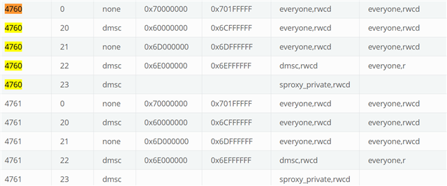

  • Hi, Diwakar,
    So, if you trying to set the background region you may see some issue as it is already configured by TIFS.
    You're right. We got this problem when we tried configuring background firewall for region 0 of fwl 4760.
    But according to J7200 DRA821 TRM,  the background regions could have overlapping addresses with foreground ones
    (I guess all regions configured by TIFS are foreground regions)
    Could you please elaborate more on why there're issues when setting the background region?
    Liang

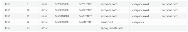

  • Hi Liang,
    If you see the above attached screenshot region 0 for both 4760 and 4761 is already configured by TIFS which is background region.
    Diwakar

  • Hi Liang
    But the region 22 and 23 is owned by TIFS and you can't reconfigure that region.
    That is why you are facing issue can you exclude the 22 and 23 region and see if you are able to set it.
    Diwakar
  • Hi, Diwakar,
    We didn't reconfigure region 22 and region 23. It is only the region 0 of 4760 that we reconfigured.
    Liang
  • Hi Liang
    When you trying to configure the region 0 for address range 0x60000000 ~ 0x7fffffff you are trying to modify the some of the range fall under region 22 and 23.
    So asked to try to configure the range excluding the range covered by region 22 and 23.
    Diwakar
  • Hi, Diwakar,
    We tried configuring region 0 with address ranges 0x70000000 ~ 0x70ffffff.
    This address range is not overlapped with region 20, 22 and 23, according to the sheet below. But we still get error -19.
    Aside from that, we thought that a background region could overlap with other foreground regions.
    Is it an exception when the region is owned by DMSC?
    Liang

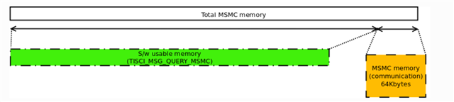

  • Hi Liang
    Are You using MSMC as LC cache or SRAM ?
    Diwakar
  • Hi, Diwakar,
    I think we're currently using MSMC as SRAM.
    May i ask why does that matter?
    Liang
  • Hi Liang
    As per the TISCI documentation the upper 64K is reserved for the  for MSMC communication.
    software-dl.ti.com/.../core.html
    If you configure the firewall avoiding this above 64K memory it should work
    Diwakar
