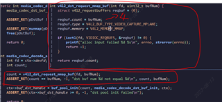

I found a special h265 file
File download link
code show as below
The result of running the program is printed below
Why not 4 but 6?
When I debugged, I found that in the wave5 driver, this value is also 6
What does this register mean, and what determines this value? When I decode other files, I always apply for 4 bufs as I wish.
