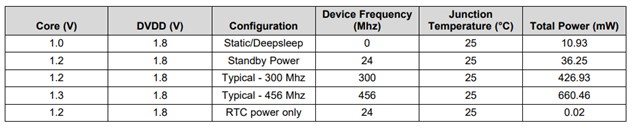

  1. If CVDD is 1.28V, can C6748 works at 400 MHz without problems?
  2. If the answer is yes, can he connect that 1.28V to RTC_CVDD, PLL0_VDDA and PLL1_VDDA?

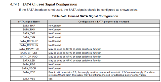

  3. Can he leave SATA_VDD floating(NC) if he doesn't use SATA function?
