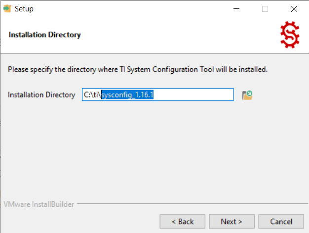

    File 'imports.mak' is expecting the folder to be called 'sysconfig_1.16.1'. However when I download that from the step by step guide, it's named 'sysconfig_1_16_1'.

    It is expected that these pages should be followed before EVM Setup page. As you may note, these pages suggests that MCU+ SDK v9.0 requires CCS v12.3 & Sysconfig 1.16.1. So, if the correct versions are installed, the SDK build works out of the box. However, if the installed versions are different then you will have to do the changes in the imports.mak file accordingly. I hope this clears the CCS version issue.
    About the Sysconfig tool naming, I have verifed that the Sysconfig v1.16.1 tool is named "sysconfig_1.16.1" on installation as shown in the below image.
    Maybe you can try reinstalling the Sysconfig tool and see if it has the correct naming.
