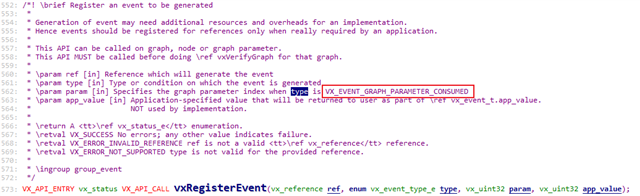

    Q1:I only modify the param 3 from 0 to 5, and the param 4 from 1 to 6 for vxRegisterEvent API, It can display normally no matter what I hotplug.
    But I'm not sure what determines the values of parameters 3 and 4?Referring to the API's instructions, I believe that parameters 3 and 4 are only valid when type is VX_EVENT_GRAPH_PARAMETER_CONSUMED, but it doesn't seem like this right now.
    I hope you can help me understand how to set the parameters of the vxRegisterEvent API.

    the last parameter, ie app_value, i dont see it being used inside the framework. It is just returned back to the application, when application is waiting on for hte node error.
    for the param, yes, it is not being used for the node error event. So can be changed.
    But i am wondering how it gets working. Is it because of the app_value? Are you not processing this app_value in the application?

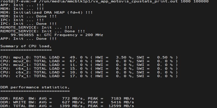

    I'm not sure what caused this problem. The only difference is that after running the USS function on MCU30, the CPU load of MCU20 will reach about 70%, and the display will flash at this time. But 70% CPU usage should still be within the normal range, right?
    If I block the operation of the USS function, even if it is unplugged, there will be no flashing display issue. At this time, the CPU usage rate of the MCU20 is below 30%.

    1)When the system starts up and does not run mcu30, the CPU usage rate of mcu20 is only about 10%. At this time, there is no flashing issue with the camera whether it is plugged or unplugged.
    2)When the system starts up and run mcu30, the CPU usage rate of MCU20 is close to 70%. At this time, there is flashing when camera unpluged.

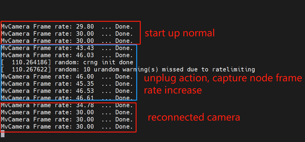

    Do you see any frame drops when you print performance stats for the capture node?
    That's a good question. In fact, the frame rate is not decreasing but increasing.But using oscilloscope to measure the mipi of the deserializer has always been 30 frames

    Is there a possibility that when camera is disconnected, virtual channel is getting messed up? Because otherwise we shouldn't see increase in fps. Decrease in fps can be due to some slowness in the SW chains but increase in fps could be due to incorrect virtual channel and this is coming from the deserializer.
    Brijesh
    However, the mipi output of the deserializer by the oscilloscope remains stable at 30fps regardless of whether the camera is being unpluged or not.The frame rate is calculated from the capture node.

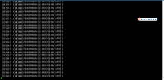

    When I unplug all 4 cameras, there is print  "Unable to add event, dropping it" all the time and never stop, only I reconnected at least one camera and the prints is stop.
    It seems that some events cannot be add successfully. But I don't know which event add failed and what cause the event add failed?
