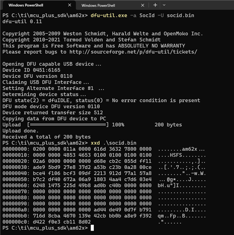

    Coming to determining the device type, if you have the DFU boot mode available you can follow the below steps:
    • Put the board in the DFU boot mode.
    • Run the below command. The command, if successful, saves the binary data received in the file named socid.bin. Please note this file must not exist before as dfu-util will create the file by itself.
      dfu-util -a SocId -U socid.bin
    • Now, to extract information from this binary file, we would need to parse it. However, since we are only interested in knowing the device type, we can simply do the hexdump of this binary file which reveals the device type. The command would be:
      xxd ./socid.bin
    For reference, the below screenshot follows the above steps and tells us the device type is HSFS.
    Prashant
  • Thank you, i was able to get the device type with the commands you sent.
    cyra@linux:~$ xxd ./socid.bin
    00000000: 0100 0000 011a 0000 616d 3632 7800 0000  ........am62x...
    00000010: 0000 0000 4750 2020 0100 0100 0100 0100  ....GP  ........
