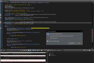

  • Hello Ralph,
    Thank you for this example. I tried to adapt it to my program an recieved these errors:
    This is my CCS project. It is a copy of the blink example.
    gpio_led_blink_am263x-lp_r5fss0-0_nortos_ti-arm-clang_V1.0.7.zip
    Please have a look why this not working.
    Thank you in advance!
    Robert

    Unfortunately your code example throws up errors when I compile it:
    Is there another way to get SEL1 and SEL2 on U23 to HIGH?
    Kind regards
    Robert
  • Hello Robert,
    I didn't highlight this as clearly as I could have but
    You'd have to restore the pins in SysConfig
    What this means is you need to go in SysConfig and add back the removed configurations for those IO. Or it may be easier to just re-load a fresh gpio_led_blink example and then make your modifications to it.
    Without SysConfig setup for the Mux pins, the code I shared won't compile.
