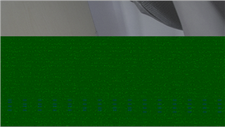

But when we running two same above 4K cameras, we cannot get video from the display.

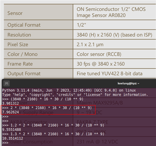

So, firstly, as titled of this thread, can CSI-Rx module handle two 4K cameras at YUV422-8bit / 30 fps?
Here is my calculation: two such camera only take 7.9G < 4 x 2.5G = 10G
Am I correct? If yes, then how can we debug CSI-Rx module about this issue?
