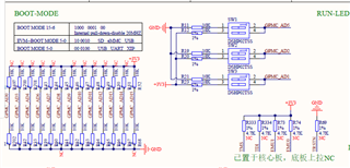

  • Dear TI team,
    I think this issue is very serious. As we only use AM571x and AM335x, we have found this issue on these two chips so far. However, I suspect that all of your chips will have this issue. It is time for you to take this issue seriously
  • Hello Zhicheng,
    We will try to recreate this on our hardware. Please give us a couple of days and we will get back to you with our status.
    Is your hardware a TI board or custom?
    -Josue
  • Dear Josue,
    1.It is a custom board and we found this problem in am335x and am571x. If you want to reproduce this issue, you can do the following in the startup script(like /etc/rc5.d/S99reboot.sh):

  • Dear Josue,
    1.Yes, this issue only occurs in the EMMC boot, because we only use EMMC boot, the SD card boot only can be used to flash emmc.
    2.After the startup fails, we copy the "bad MLO" image inside and place it in other bootable devices, which can still be started.
    3.We have been using tools to restart 5 devices for 15 days and have not found any restart failures so far. So this issue is related to "MLO" rather than "booting".
