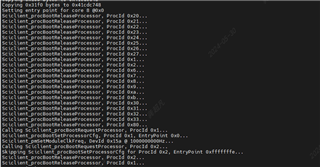

TDA4VH-Q1: SDL bist function with boot_app on J784S4_EVM
Part Number: TDA4VH-Q1
Hi Ti expert:
    I implement SDL bist function from SDL example from the generated image.There has two images bist_example_r5f_baremetal_multicore_image.appimage and bist_example_r5f_baremetal_release.appimage.
    I get bist_example_r5f_baremetal_multicore_image.appimage include one MCU1_0 test app and C71 clearClecSerureCalim and  another one MCU1_0 app doesn't work.From the uart boot log ,I can see C71 and MCU1_0 boot from SBL.
   So the problems has happened,In the regular project the custom C71 code need to boot from MCU1_0 boot_app in the MCU1_0 app,I need implement bist function and boot custom C71.
    I try move clear secure code to custom C71 code,it seems work well,but when the PBIST and LBIST functions are done,try to boot A72 and Main R5 ,c71 are failed no any uart log.I use the XDS110 try to connect debug but failed.
    Can you give me any suggestion or example can implement two function from the SDK? by the way the SDK9.0 /mcusw/mcuss_demos/boot_app_mcu_rtos can you show the selftest report?

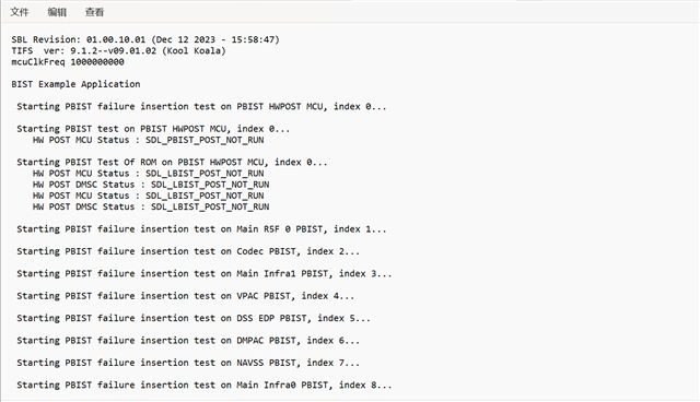

    The SDL Release notes indicate any known issues in a given SDK: 1.1. Release Notes - 01_00_00 — Software Diagnostics Library (SDL) - J784S4 User Guide
    The SDL example section has logs for each test are shown including the BIST tests.  These tests are the stand alone test images:
    3.8. BIST Safety Example — Software Diagnostics Library (SDL) - J784S4 User Guide

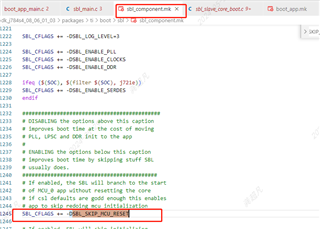

  • With the assumption that SDK 9.0 is in use, the PDK SBL contains both the SBL and a Boot app example, which should function as-is.
    If there are issues with the SBL and/or SBL boot application example in SDK 9.0, please provide logs.
    The alternative approach is to use the boot application in mcusw, with the PDK SBL.
    If there are issues/questions, with either of the boot applications please let us know.
    In either of these boot applications, SDL code can be integrated.

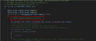

  • I already integrated it once,only two cases can pass,you should do once reproduce,this is a very obvious problem.You should do it once and tell me the result.
    TI team will check for availability of any patches that can be shared.
    In parallel if you could provide logs, or a description of what issues you are facing with the integration effort this would be helpful.
    kb
    As discussed on the internal mail thread, the C7x secure claim bit is an issue, and will effect performance and complexity on SDK 8.6.
    I will provide a partial patch for SDK 8.6, where a subset of the PBIST / LBIST tests are shown to be functional in SBL boot application, in two weeks.
    Although, it is recommended that you move to SDK 9.1 for production, to avoid the C7x Secure Claim bit issue.

  • I do PBIST_runTest
    parameter 3 sub case i = 1 found error
    parameter 7 sub case 1 found error
    We have identified some issues with the flow sequence of the MCUSW BootApp on SDK 8.6, which have been resolved in SDK 9.0. As a result, there have been some integration failures with BIST.
     However, we have alternative solutions available:
    1.  We could either work with the SBL boot flow on SDK 8.6. I have an experimental patch that you could refer to and test BIST with SBL.
    2. I can work on integrating BIST with the MCUSW BootApp on SDK 9.0.
    Note: Both these approaches are expected to work partially as clarified earlier, where a subset of the PBIST / LBIST tests are shown to be functional in MCUSW boot application.
    Please let me know which option you prefer and we will proceed accordingly. I apologize for any inconvenience caused.

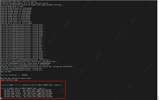

  • HI!
        Thanks for your reply!
        We have obtained the latest package (SDK9.1) for relevant testing. Verified using BIST function alone, but the boot function has not been validated after BIST.
    Thank you!
    I have reproduced the issue on SDK 9.1. I see that the boot flow halts when loading lateapp2. I am debugging the issue and will get back to you in a couple of weeks.
    Josiitaa
  • update the issue status: Current SBL+QNX do bist has been finished and verified on EVM but SBL+ Linux will be stuck on the kernel mount rootfs.

    SBL Revision: 01.00.10.01 (Jan 16 2024 - 19:50:17)
    TIFS  ver: 9.1.2--v09.01.02 (Kool Koala)
    SCISERVER Board Configuration header population... PASSED
    Sciclient_setBoardConfigHeader... PASSED
    Initlialzing PLLs ...done.
    InitlialzingClocks ...done.
     Starting PBIST failure insertion test on Main Infra1 PBIST, index 3...
     Starting PBIST test on Main Infra1 PBIST, index 3...
     Starting PBIST failure insertion test on Main Infra0 PBIST, index 8...
     Starting PBIST test on Main Infra0 PBIST, index 8...
    PBIST functional test failed for 8
     Starting PBIST failure insertion test on MSMC PBIST, index 26...
     Starting PBIST test on MSMC PBIST, index 26...
     Starting PBIST failure insertion test on NAVSS PBIST, index 7...
     Starting PBIST test on NAVSS PBIST, index 7...
     Starting PBIST failure insertion test on HC PBIST, index 10...
     Starting PBIST test on HC PBIST, index 10...
    Resetting Main Domain ...done.
    Recovering Main Domain ...Unlocking pll mmrs ...done.
    Unlocking CTRL MMRs ...done.
    done.
    Initlialzing DDR ...done.
    Initializing GTC ...Copying EEPROM content to DDR ...
    EEPROM Data Copy Done.
    Begin parsing user application
    Calling Sciclient_procBootRequestProcessor, ProcId 0x20...
    Calling Sciclient_procBootRequestProcessor, ProcId 0x21...
    Calling Sciclient_procBootRequestProcessor, ProcId 0x22...
    Calling Sciclient_procBootRequestProcessor, ProcId 0x23...
    Calling Sciclient_procBootRequestProcessor, ProcId 0x24...
    Calling Sciclient_procBootRequestProcessor, ProcId 0x25...
    Calling Sciclient_procBootRequestProcessor, ProcId 0x26...
    Calling Sciclient_procBootRequestProcessor, ProcId 0x27...
    Calling Sciclient_procBootRequestProcessor, ProcId 0x1...
    Calling Sciclient_procBootRequestProcessor, ProcId 0x2...
    Calling Sciclient_procBootRequestProcessor, ProcId 0x6...
    Calling Sciclient_procBootRequestProcessor, ProcId 0x7...
    Calling Sciclient_procBootRequestProcessor, ProcId 0x8...
    Calling Sciclient_procBootRequestProcessor, ProcId 0x9...
    Calling Sciclient_procBootRequestProcessor, ProcId 0xa...
    Calling Sciclient_procBootRequestProcessor, ProcId 0xb...
    Calling Sciclient_procBootRequestProcessor, ProcId 0x30...
    Calling Sciclient_procBootRequestProcessor, ProcId 0x31...
    Calling Sciclient_procBootRequestProcessor, ProcId 0x32...
    Calling Sciclient_procBootRequestProcessor, ProcId 0x33...
    Calling Sciclient_procBootRequestProcessor, ProcId 0x80...
    Searching for X509 certificate ...not found
    Switching core id 8, proc_id 0x1 to split mode...
    Calling Sciclient_procBootGetProcessorState, ProcId 0x1...
    Sciclient_procBootSetProcessorCfg, ProcId 0x1, enabling split mode...
    Enabling MCU TCMs after reset for core 8
    Disabling HW-based memory init of MCU TCMs for core 8
    Sciclient_procBootSetProcessorCfg update TCM enable/disable settings...
    Copying 0x40 bytes to 0x0
    Copying 0x20940 bytes to 0x41c82000
    Copying 0xe6a8 bytes to 0x41cbb880
    Copying 0x53b0 bytes to 0x41cd1f28
    Copying 0x1604 bytes to 0x41cd8a80
    Copying 0x4d0 bytes to 0x41cda088
    Copying 0x358 bytes to 0x41cda558
    Copying 0x100 bytes to 0x41cda8b0
    Copying 0x58 bytes to 0x41cda9b0
    Copying 0x3718 bytes to 0x41cdaa08
    Setting entry point for core 8 @0x0
    Sciclient_procBootReleaseProcessor, ProcId 0x20...
    Sciclient_procBootReleaseProcessor, ProcId 0x21...
    Sciclient_procBootReleaseProcessor, ProcId 0x22...
    Sciclient_procBootReleaseProcessor, ProcId 0x23...
    Sciclient_procBootReleaseProcessor, ProcId 0x24...
    Sciclient_procBootReleaseProcessor, ProcId 0x25...
    Sciclient_procBootReleaseProcessor, ProcId 0x26...
    Sciclient_procBootReleaseProcessor, ProcId 0x27...
    Sciclient_procBootReleaseProcessor, ProcId 0x1...
    Sciclient_procBootReleaseProcessor, ProcId 0x2...
    Sciclient_procBootReleaseProcessor, ProcId 0x6...
    Sciclient_procBootReleaseProcessor, ProcId 0x7...
    Sciclient_procBootReleaseProcessor, ProcId 0x8...
    Sciclient_procBootReleaseProcessor, ProcId 0x9...
    Sciclient_procBootReleaseProcessor, ProcId 0xa...
    Sciclient_procBootReleaseProcessor, ProcId 0xb...
    Sciclient_procBootReleaseProcessor, ProcId 0x30...
    Sciclient_procBootReleaseProcessor, ProcId 0x31...
    Sciclient_procBootReleaseProcessor, ProcId 0x32...
    Sciclient_procBootReleaseProcessor, ProcId 0x33...
    Sciclient_procBootReleaseProcessor, ProcId 0x80...
    Sciclient_procBootSetProcessorCfg, ProcId 0x1, EntryPoint 0x0...
    Sciclient_pmSetModuleClkFreq, DevId 0x15a @ 1000000000Hz...
    Skipping Sciclient_procBootSetProcessorCfg for ProcId 0x2, EntryPoint 0xfffffffe...
    Starting Sciserver..... PASSED
    MCU R5F App started at 0 usecs
     Starting PBIST failure insertion test on PBIST HWPOST MCU, index 0...
     Starting PBIST test on PBIST HWPOST MCU, index 0...
        HW POST MCU Status : SDL_PBIST_POST_COMPLETED_SUCCESS
     Starting PBIST Test Of ROM on PBIST HWPOST MCU, index 0...
        HW POST MCU Status : SDL_LBIST_POST_NOT_RUN
        HW POST DMSC Status : SDL_LBIST_POST_NOT_RUN
    Copying 0xe680 bytes to 0x41cbb880
    Copying 0x53b0 bytes to 0x41cd1f00

     Starting PBIST Test Of ROM on Main R5F 1 PBIST, index 27...
     Starting PBIST Test Of ROM on PBIST MCU PSROM, index 28...
     Starting PBIST Test Of ROM on PBIST MCU_1, index 29...
     Starting PBIST Test Of ROM on PBIST MCU PULSAR, index 30...
     *** Boot stage 0 is complete, cores for this stage may now be loaded ***
     *** Boot stage 1 is complete, cores for this stage may now be loaded ***
     *** Boot stage 2 is complete, cores for this stage may now be loaded ***

    Loading BootImage
     BootApp_MMCBootImageLate: fp 0x 0x41c12300, fileName is 0:/lateapp1
    Switching core id 10, proc_id 0x6 to split mode...
    Calling Sciclient_procBootGetProcessorState, ProcId 0x6...
    Sciclient_procBootSetProcessorCfg, ProcId 0x6, enabling split mode...
    Sciclient_pmSetModuleState Off, DevId 0x153...
    Enabling MCU TCMs after reset for core 10
    Disabling HW-based memory init of MCU TCMs for core 10
    Setting HALT for ProcId 0x6...
    Sciclient_pmSetModuleState On, DevId 0x153...
    Clearing core_id 10 (lock-step) ATCM @ 0x5c00000
    Clearing core_id 10 (lock-step) BTCM @ 0x5c10000
    Translating coreid 10 local ATCM addr 0x0 to SoC MCU ATCM addr 0x5c00000
    Copying 0x40 bytes to 0x5c00000
    Translating coreid 10 local ATCM addr 0x40 to SoC MCU ATCM addr 0x5c00040
    Copying 0x508 bytes to 0x5c00040
    Translating coreid 10 local ATCM addr 0x548 to SoC MCU ATCM addr 0x5c00548
    Copying 0x358 bytes to 0x5c00548
    Translating coreid 10 local ATCM addr 0x8a0 to SoC MCU ATCM addr 0x5c008a0
    Copying 0x120 bytes to 0x5c008a0
    Translating coreid 10 local ATCM addr 0x9c0 to SoC MCU ATCM addr 0x5c009c0
    Copying 0x58 bytes to 0x5c009c0
    Copying 0x8c bytes to 0xa2100000
    Copying 0x2c0 bytes to 0xa2100400
    Copying 0xdf2c0 bytes to 0xa34b2000
    Copying 0x44de0 bytes to 0xa36cb800
    Copying 0x1e0a8 bytes to 0xa37285e0
    Setting entry point for core 10 @0x0
    Sciclient_pmSetModuleState Off, DevId 0x154...
    Calling Sciclient_procBootGetProcessorState, ProcId 0x7...
    Enabling MCU TCMs after reset for core 11
    Setting HALT for ProcId 0x7...
    Sciclient_pmSetModuleState On, DevId 0x154...
    Clearing core_id 11 (lock-step) ATCM @ 0x5d00000
    Clearing core_id 11 (lock-step) BTCM @ 0x5d10000
    Translating coreid 11 local ATCM addr 0x0 to SoC MCU ATCM addr 0x5d00000
    Copying 0x40 bytes to 0x5d00000
    Translating coreid 11 local ATCM addr 0x40 to SoC MCU ATCM addr 0x5d00040
    Copying 0x508 bytes to 0x5d00040
    Translating coreid 11 local ATCM addr 0x548 to SoC MCU ATCM addr 0x5d00548
    Copying 0x358 bytes to 0x5d00548
    Translating coreid 11 local ATCM addr 0x8a0 to SoC MCU ATCM addr 0x5d008a0
    Copying 0x120 bytes to 0x5d008a0
    Translating coreid 11 local ATCM addr 0x9c0 to SoC MCU ATCM addr 0x5d009c0
    Copying 0x58 bytes to 0x5d009c0
    Copying 0x8c bytes to 0xa4100000
    Copying 0x2c0 bytes to 0xa43831fc
    Copying 0x2b860 bytes to 0xa4588000
    Copying 0x1ee10 bytes to 0xa45b3860
    Copying 0xcc8 bytes to 0xa45f1e00
    Setting entry point for core 11 @0x0
     Called SBL_MulticoreImageParse, status = 0
    BootImage completed, status = 0
    Sciclient_procBootSetProcessorCfg, ProcId 0x6, EntryPoint 0x0...
    Sciclient_pmSetModuleClkFreq, DevId 0x153 @ 1000000000Hz...
    Clearing HALT for ProcId 0x6...
    SBL_SlaveCoreBoot completed for Core ID#10, Entry point is 0x0
    Sciclient_procBootSetProcessorCfg, ProcId 0x7, EntryPoint 0x0...
    Sciclient_pmSetModuleClkFreq, DevId 0x154 @ 1000000000Hz...
    Sciclient_procBootSetProcessorCfg, ProcId 0x8, EntryPoint 0x0...
    Sciclient_pmSetModuleClkFreq, DevId 0x155 @ 1000000000Hz...
    Clearing HALT for ProcId 0x8...
    SBL_SlaveCoreBoot completed for Core ID#12, Entry point is 0x0
    Sciclient_procBootSetProcessorCfg, ProcId 0x9, EntryPoint 0x0...
    Sciclient_pmSetModuleClkFreq, DevId 0x156 @ 1000000000Hz...
    Clearing HALT for ProcId 0x9...
    SBL_SlaveCoreBoot completed for Core ID#13, Entry point is 0x0
    Sciclient_procBootSetProcessorCfg, ProcId 0xa, EntryPoint 0x0...
    Sciclient_pmSetModuleClkFreq, DevId 0x157 @ 1000000000Hz...
    Clearing HALT for ProcId 0xa...
    SBL_SlaveCoreBoot completed for Core ID#14, Entry point is 0x0
    Sciclient_procBootSetProcessorCfg, ProcId 0xb, EntryPoint 0x0...
    Sciclient_pmSetModuleClkFreq, DevId 0x158 @ 1000000000Hz...
    Clearing HALT for ProcId 0xb...
    SBL_SlaveCoreBoot completed for Core ID#15, Entry point is 0x0
    Sciclient_procBootSetProcessorCfg, ProcId 0x30, EntryPoint 0xb2200000...
    Sciclient_pmSetModuleClkFreq, DevId 0x1e @ 1000000000Hz...
    Sciclient_pmSetModuleState Off, DevId 0x164...
    Sciclient_pmSetModuleState Off, DevId 0x1f...
    Sciclient_pmSetModuleState Off, DevId 0x1e...
    Sciclient_pmSetModuleState On, DevId 0x1e...
    SBL_SlaveCoreBoot completed for Core ID#18, Entry point is 0xb2200000
    Sciclient_procBootSetProcessorCfg, ProcId 0x31, EntryPoint 0xb4200000...
    Sciclient_pmSetModuleClkFreq, DevId 0x21 @ 1000000000Hz...
    Sciclient_pmSetModuleState Off, DevId 0x165...
    Sciclient_pmSetModuleState Off, DevId 0x22...
    Sciclient_pmSetModuleState Off, DevId 0x21...
    Sciclient_pmSetModuleState On, DevId 0x21...
    SBL_SlaveCoreBoot completed for Core ID#19, Entry point is 0xb4200000
    Sciclient_procBootSetProcessorCfg, ProcId 0x32, EntryPoint 0xb6200000...
    Sciclient_pmSetModuleClkFreq, DevId 0x25 @ 1000000000Hz...
    Sciclient_pmSetModuleState Off, DevId 0x166...
    Sciclient_pmSetModuleState Off, DevId 0x26...
    Sciclient_pmSetModuleState Off, DevId 0x25...
    Sciclient_pmSetModuleState On, DevId 0x25...
    SBL_SlaveCoreBoot completed for Core ID#20, Entry point is 0xb6200000
    Sciclient_procBootSetProcessorCfg, ProcId 0x33, EntryPoint 0xb8200000...
    Sciclient_pmSetModuleClkFreq, DevId 0x28 @ 1000000000Hz...
    Sciclient_pmSetModuleState Off, DevId 0x167...
    Sciclient_pmSetModuleState Off, DevId 0x29...
    Sciclient_pmSetModuleState Off, DevId 0x28...
    Sciclient_pmSetModuleState On, DevId 0x28...
    SBL_SlaveCoreBoot completed for Core ID#21, Entry point is 0xb8200000

    Problem at app bist test step, mcu domain outputs log as below:
    SBL Revision: 01.00.10.01 (Apr  1 2024 - 14:13:27)
    TIFS  ver: 8.6.3--1-g2249f (Chill Capybara
     Starting PBIST failure insertion test on Main Infra1 PBIST, index 3…
     Starting PBIST test on Main Infra1 PBIST, index 3…
     Starting PBIST failure insertion test on Main Infra0 PBIST, index 8…
     Starting PBIST test on Main Infra0 PBIST, index 8…
     Starting PBIST failure insertion test on MSMC PBIST, index 26…
     Starting PBIST test on MSMC PBIST, index 26…
     Starting PBIST failure insertion test on NAVSS PBIST, index 7…
     Starting PBIST test on NAVSS PBIST, index 7…
     Starting PBIST failure insertion test on HC PBIST, index 10…
     Starting PBIST test on HC PBIST, index 10…
    Starting Sciserver….. PASSED
     Starting PBIST failure insertion test on PBIST HWPOST MCU, index 0…
     Starting PBIST test on PBIST HWPOST MCU, index 0…
        HW POST MCU Status : SDL_PBIST_POST_NOT_RUN
     Starting PBIST Test Of ROM on PBIST HWPOST MCU, index 0…
    Only replace the tifs.bin in the above file with the version of sdk9.1, bist works normally and can start other cores normally, but the linux startup process reports an error, and the A-core output log is as follows:

    Change as below should be work
    ./sdl/examples/bist/bist.c
    ./sdl/examples/bist/soc/j784s4/bist_core_defs.c
  • It worked on the EVM now.
    MCU log:
    SBL Revision: 01.00.10.01 (Jun 13 2024 - 15:56:40)
    TIFS  ver: 8.6.3--v08.06.03 (Chill Capybar
