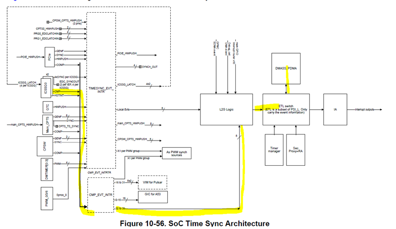

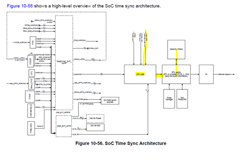

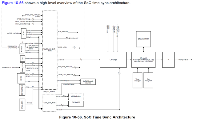

    IEP timer: > CMP_EVE_INTRR; > L2G; > DMASS0
    You have to follow the steps below.

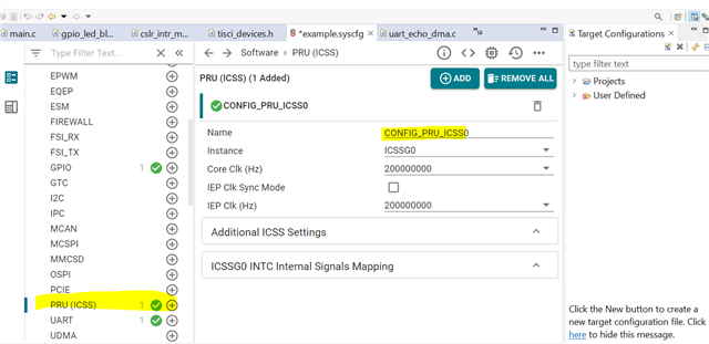

    Step1 :
    IEP timers are available in PRU cores, and you should enable PRU cores and IEP timers from the system configuration.
    You can look at an example system cfg for your reference.
    Step2:
    Use any timer either IEP1 and IEP2 and select one CMP_EVENT among eight CMP_EVENTS .
    Step3:
    Next, route CMP events to CMP_ENT_INTR; for that, we need to configure the SCI client since we can't write direct values into the INTR ROUTER Register.
    Please check out the example SCI client configuration function for your reference.
    Step4:

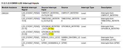

    Converting local events to global event though there is L2G register and that we need to select local event no. and gloab event no.
    Please check out the L2G function for more details.
    To configure SCi client to route CMP EVENTS to CMP EVENT INTR Router, we need src index and dst index, and this information should be available in the link below.
    https://software-dl.ti.com/tisci/esd/latest/5_soc_doc/am64x/resasg_types.html
    And currently in the example, I am checking whether the timer is expired or not. If the timer is expired, I was assuming that UDMA data transfer completion was over and reading data from UDMA, but here, instead of checking the timer expiration status, you can use the status of the UDMA completion event.

  • Thanks for your reply.
    In step one by mentioning system configuration, do you mean this is kind of a board configuration and should be done in sciclient_ccs_init level before programming the application?
    Step1 :
  • In step one by mentioning system configuration, do you mean this is kind of a board configuration and should be done in sciclient_ccs_init level before programming the application?
    No, Boshra. You don't need to enable them in the board configuration.
    Just enable them in the system configuration file and generate code.
    Please check out the attached example.
    For your reference, I have attached the image below.

    So using these timers makes it necessary to use the PRU cores? There is no other outside the PRU that can trigger BCDMA? For example, GTC timers are not able to trigger BCDMA?
    I believe BCDMA can also be triggered by GPIO from an external device. Do you have an example for that too?
    Boshra
  • Boshara,
    Yes, when you want the IEP timers, you should use the PRU cores.
    I have given an example based on the IEP timer and CMP_INTR router, which you can do for other timers with different interrupt routers.
    You can try with GTC Timer as well; there is a Hwpush event going to the Timer sync event interrupt router.

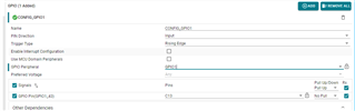

    Software Changes :
    1. Configure GPIO as an input based on your requirements.
    2. Enable GPIO Interrupt Routers 16 to 17 or 30 to 37. Since these routers only connected to L2G.
    Currently, in the software, these routers are not configured.
    So, I have manually updated only the GPIO-16 router in the sciclient_defaultBoardcfg_rm.c file.

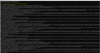

    You have to give the below command to compile it.
    4. Compile SBL and Flash SBL with updated board config file
    5. Run your Application from CCS .

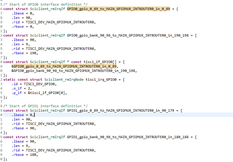

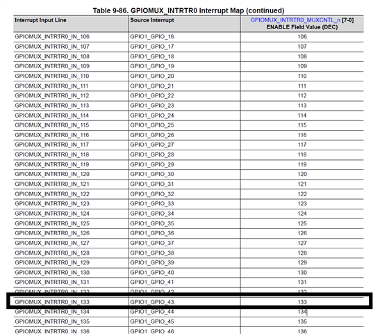

    There is part of this code that is not clear to me. For tisci_msg_rm_irq_set_req, it has set the src_index to 92:
    #define TISCI_GPIO_BANK_INT_SRC_IDX_BASE_GPIO0      ( 90U )
    #define TISCI_GPIO_BANK_INT_SRC_IDX_BASE_GPIO1      ( 90U )
    #define TISCI_GPIO_BANK_INT_SRC_IDX_BASE_MCU_GPIO0  ( 30U )
    #define TISCI_GPIO1_BANK_INT_SRC_IDX(x)             ( TISCI_GPIO_BANK_INT_SRC_IDX_BASE_GPIO1 + x )
    However, when I check the TRM, I see that for GPIO1_GPIO43, the INTRR0_In is 133.
    where this 92 is coming from?

  • But does it still mean that I need to use the PRU cores?
    No, it does not require a PRU core. It can be used as a 64-bit counter and is available on the Main Domain (A53 and R5F).
    But you need to stick time based on the PUSH event of the GTC timer, and that event should be configured from bit value 0 to 63.
    Other than GTC and IEP, we don't have any other timers to automatically trigger DMA.
    In the above example, I was trying to enable the bank interrupt for the GPIO1_43 pin. If you see the below image in the TRM, GPIO1_43 comes under the Bank 2 interrupt number, and the router output would be 182. So, I need to send 182 values, but I was sending 92. Here is another 90 offset that will be taken care of by the sciclient irq set function.
    So, if you need the pin interrupt, just pass the pin number, and if you need the bank interrupt , it is 90 offset +  bank number and the final 90 offset value will be taken care of by the sciclient irq set function in both cases .
    the RM file of AM64X is divided GPIO pins into two groups
    1. GPIO 0 bank interrupts and pin interrupts
    2. GPIO1 bank interrupts and pin interrupts
    If you need more details, please go through this file so you can understand why an offset value is needed.
    File name : sciclient_irq_rm
    C:\ti\mcu_plus_sdk_am64x_09_00_00_31\source\drivers\sciclient\soc\am64x_am243x

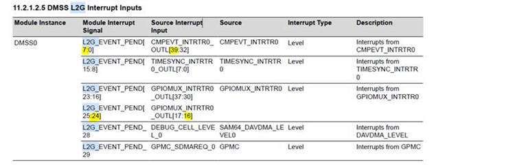

    Does it mean GPIO1_Pin43 Can generate interrupt both under pin interrupt (133), and also bank interrupt (182)?
    Also regarding the L2G, in this case you used L2G_EVENT[24] which corresponds to GPIOMUX_OUT_INTRTR0_OUTL[16]. and from the other hand in the sciclient set irq function we gave the L2G_EVENT[24] as well as the src interrupt which is GPIO1_BANK2_INT. So it means that instead of GPIO1_BANK2_INT we could give any other bank interrupt or pin interrupt that we wanted (that exist for main domain). Is that right?
    Boshra
  • Does it mean GPIO1_Pin43 Can generate interrupt both under pin interrupt (133), and also bank interrupt (182)?
    Boshra,
    Yes, your understanding is correct, but you can route either a pin interrupt or a bank interrupt to the GPIO MUX interrupt router output.
    Yes, your understanding is correct. You can give any pin or bank interrupt; it should work. Make sure that GPIOMUX_OUT_INTRTR0_OUTL[16] output is properly configured in the rm_cfg.c file, as it is clearly stated in the above comments.
