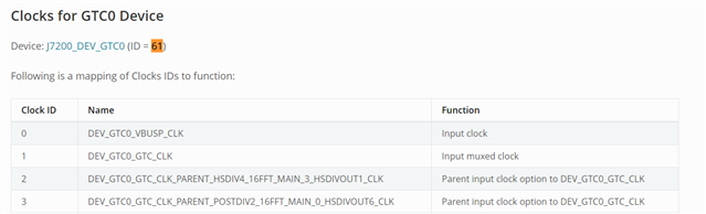

    I checked internally as well. The GTC is definitely feeding into Arch timer of A72. Hence we hook that on to A72 DTS.
    U-Boot dts file: arch/arm/dts/k3-j7200-r5-common-proc-board.dts
    So the 61 clk is the GTC.
    "If you want to compute the elapsed time between two events observed on the one machine without an intervening reboot, CLOCK_MONOTONIC is the best option."
    https://stackoverflow.com/questions/3523442/difference-between-clock-realtime-and-clock-monotonic
    So GTC looks to be the common clock that can be used across cores.
