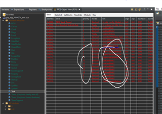

  • Another thing, it seems that the program gets in a loop of edma rm error handler.

    What I see sometimes is an EDMA error handler loop, on tcc which is not registered by rm, and global flag handling does not solve the error.
    What I also found is that sometimes exceptions happen when TimeSync_reset is called.

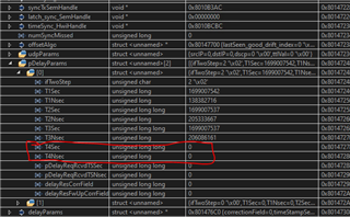

    Think I found reason why path delay is not calculated.
    In icss_timeSync.c, Line 1440:
                if(timeSyncHandle->timeSyncConfig.timestamp_from_shared_ram)
                    TimeSync_getRxTimestamp(timeSyncHandle, DELAY_RESP_FRAME, portNum, \
                                            &nanoseconds, &seconds);
                /*T4 timestamp*/
                timeSyncHandle->pDelayParams[portNum - 1].T4Sec =
                    seconds;
                timeSyncHandle->pDelayParams[portNum - 1].T4Nsec =
                    nanoseconds;
    Timestamp_from_shared_ram == 1
    But for T4 seconds, and nanoseconds are always 0.
    Times T1, T2, T3 seems have some non-0 values, but T4 is always 0.
    This make in TimeSync_peerDelayCalc function wrong calculation of T4_T1_diff. Also, NRR value is INF. So, the mean delay value is bigger then limit TIMESYNC_PEER_DELAY_ERROR_THRESHOLD.
    Any idea?
    Is there problem whit timestamp?
    Best regards, Mare

    I found the reason for TimeSync_reset issue. I copy icss_timesync.c in project to be able to debug path delay error, and timesync from app take icss_timeSyncApi.h from DAN folder which has for handler different structure than icss_timeSyncApi.h in PDK.
    Anyway, PTP still can't sync.

    I try your patch, but unfortunately, I don't see any progress
    There are still missing timestamps for T4.
    Did you get PTP working with your patch in the lab?
    This are crazy numbers fom Hirshman PRP PTP switch:
    And this are values from pDelay param on IDK:
    Am I doing something wrong?
    Did you manage to make PTP work with your team?
    p.s.
    Thanks for your effort, sir! I'm very glad that someone helping me with that.
    Best Regards, Mare

    Please find the memory records of OCMC in attachment.
    Unfortunately, I can't make PTP work. T4 filds on delay param are still 0.
    I use the default configuration, as is from the example. What I changed is "timestamp_from_shared_ram" set to 0 (by project example it was 1).ptp_debuging_OCMC.zip

    I can confirm that your .out is working with the Hirshman setup. Path delay is calculated and sync.
    My code does not have any changes in operations. Still can't get T4 parameters.
    When I build prp_lib I notice that pdksetup setup path to "C:\ti\pdk_am437x_1_0_12\packages", I changed to C:\ti\pdk_am437x_1_0_17\packages.
    I check that prp_libxxx.a and ti.transport.timeSync.aa9fg has been created (new files).
    I think that we probably do not have the same source files.
    We have some partial changes... Can you please send me your files, which were modified over the patching procedure? (or I ask too much).
    I probably miss something.
    If I understand you, my firmware .h files for ICSS-PRU are identical whit yours?
    Not sure if I understand correctly, "timeSyncHandle->timeSyncConfig.timestamp_from_shared_ram" need to be 0 or 1? (if I set it to 0, the program crashes. by default in original example is 1).
    Did you build your .out as a release or debug?
    Best Regards, Mare

    I can also confirm that whit timestamp_from_shared_ram = 0, program crash in edma3 error handler after 15s.
    I think we have different source code. If possible ziped PRU-ICSS-HSR-PRP-DAN_01.00.05.01 folder will be first step if you can confirm that we have equal content of .h files in PRU-ICSS-HSR-PRP-DAN_01.00.05.01\protocols\hsr_prp\firmware\prp\v1.0 .
    Mare

    Two more things:
    I noticed a long time ago, that on ROV task names or fxn is corrupted when debugging code. I also report this on the forum. Was this also counted in the fix procedure?
    Which CCS is recommended to use with RC?
    Thanks, Himanshu.

    Is it possible that CCS or PDK version make this fix unsuccessful?
    Regards, Mare

  • Hi Marko,
    I would be able to share the package with you on Monday.
    I will also check if I am able to see the ROV issue.
    Himanshu
