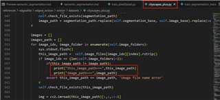

============= Diagnostic Run torch.onnx.export version 2.0.1+cu118 =============
verbose: False, log level: Level.ERROR
======================= 0 NONE 0 NOTE 0 WARNING 0 ERROR ========================
=> setting adam optimizer
=> validation 100.00% of 1x42...Epoch=1/1, DataTime=0.2729, Output=[MeanIoU=0.4776] rate=0.27 Hz, eta=0:00:00, total=0:02:36
Traceback (most recent call last):
File "/home/machunlei/codes/edgeai-torchvision-master/./references/edgeailite/main/pixel2pixel/train_segmentation_main.py", line 278, in <module>
run(args)
File "/home/machunlei/codes/edgeai-torchvision-master/./references/edgeailite/main/pixel2pixel/train_segmentation_main.py", line 273, in run
main(arguments)
File "/home/machunlei/codes/edgeai-torchvision-master/./references/edgeailite/main/pixel2pixel/train_segmentation_main.py", line 123, in main
train_pixel2pixel.main(arguemnts)
File "/home/machunlei/codes/edgeai-torchvision-master/references/edgeailite/edgeai_xvision/xengine/train_pixel2pixel.py", line 614, in main
train(args, train_dataset, train_loader, model, optimizer, epoch, train_writer, scheduler, grad_scaler)
File "/home/machunlei/codes/edgeai-torchvision-master/references/edgeailite/edgeai_xvision/xengine/train_pixel2pixel.py", line 721, in train
for iter_id, (inputs, targets) in enumerate(train_loader):
File "/usr/local/anaconda3/envs/edgeai-tv/lib/python3.10/site-packages/torch/utils/data/dataloader.py", line 633, in __next__
data = self._next_data()
File "/usr/local/anaconda3/envs/edgeai-tv/lib/python3.10/site-packages/torch/utils/data/dataloader.py", line 1345, in _next_data
return self._process_data(data)
File "/usr/local/anaconda3/envs/edgeai-tv/lib/python3.10/site-packages/torch/utils/data/dataloader.py", line 1371, in _process_data
data.reraise()
File "/usr/local/anaconda3/envs/edgeai-tv/lib/python3.10/site-packages/torch/_utils.py", line 644, in reraise
raise exception
AssertionError: Caught AssertionError in DataLoader worker process 0.
Original Traceback (most recent call last):
File "/usr/local/anaconda3/envs/edgeai-tv/lib/python3.10/site-packages/torch/utils/data/_utils/worker.py", line 308, in _worker_loop
data = fetcher.fetch(index)
File "/usr/local/anaconda3/envs/edgeai-tv/lib/python3.10/site-packages/torch/utils/data/_utils/fetch.py", line 51, in fetch
data = [self.dataset[idx] for idx in possibly_batched_index]
File "/usr/local/anaconda3/envs/edgeai-tv/lib/python3.10/site-packages/torch/utils/data/_utils/fetch.py", line 51, in <listcomp>
File "/home/machunlei/codes/edgeai-torchvision-master/references/edgeailite/edgeai_xvision/xvision/datasets/cityscapes_plus.py", line 357, in __getitem__
assert this_image_path == image_path, 'image file name error'
AssertionError: image file name error
The bug is "
this_image_path == image_path".There is something wrong with training. Why is the validation ok? So,I added print like this.
=> validation 100.00% of 1x42...Epoch=1/1, DataTime=1.062, Output=[MeanIoU=0.4776] rate=0.22 Hz, eta=0:00:00, total=0:03:08
this_image_path===this_image_path=== ../datasets/cityscapes/leftImg8bit/train/zurich/zurich_000038_000019_leftImg8bit.png ../datasets/cityscapes/leftImg8bit/train/strasbourg/strasbourg_000001_017844_leftImg8bit.png
image_path=== image_path===../datasets/cityscapes/leftImg8bit/train/strasbourg/strasbourg_000001_018155_leftImg8bit.png
../datasets/cityscapes/leftImg8bit/train/zurich/zurich_000040_000019_leftImg8bit.png
this_image_path=== ../datasets/cityscapes/leftImg8bit/train/jena/jena_000055_000019_leftImg8bit.png
image_path=== ../datasets/cityscapes/leftImg8bit/train/jena/jena_000056_000019_leftImg8bit.png
this_image_path=== ../datasets/cityscapes/leftImg8bit/train/hanover/hanover_000000_004230_leftImg8bit.png
image_path=== ../datasets/cityscapes/leftImg8bit/train/hanover/hanover_000000_004646_leftImg8bit.png
this_image_path=== ../datasets/cityscapes/leftImg8bit/train/hamburg/hamburg_000000_091038_leftImg8bit.png
image_path=== ../datasets/cityscapes/leftImg8bit/train/hamburg/hamburg_000000_091155_leftImg8bit.png
this_image_path=== ../datasets/cityscapes/leftImg8bit/train/monchengladbach/monchengladbach_000000_011383_leftImg8bit.png
image_path=== ../datasets/cityscapes/leftImg8bit/train/monchengladbach/monchengladbach_000000_012376_leftImg8bit.png
this_image_path=== ../datasets/cityscapes/leftImg8bit/train/strasbourg/strasbourg_000001_065214_leftImg8bit.png
image_path=== ../datasets/cityscapes/leftImg8bit/train/strasbourg/strasbourg_000001_065572_leftImg8bit.png
run(args)
main(arguments)
data.reraise()
raise exception
File "/home/machunlei/codes/edgeai-torchvision-master/references/edgeailite/edgeai_xvision/xvision/datasets/cityscapes_plus.py", line 360, in __getitem__
this_image_path=== ../datasets/cityscapes/leftImg8bit/train/monchengladbach/monchengladbach_000000_019901_leftImg8bit.png
image_path=== ../datasets/cityscapes/leftImg8bit/train/monchengladbach/monchengladbach_000000_020303_leftImg8bit.png
(edgeai-tv) root@zhouxin:/home/machunlei/codes/edgeai-torchvision-master#
