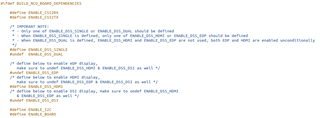

I followed the instructions Vision Apps User Guide: Run Instructions,but I was unable to display via HDMI

This macro is for enabling HDMI output using additional daughter card.
I believe SK uses on board HDMI and probably controlling DSS from Linux, so this method cannot be used.

Hi Yang,
Vission apps in not supported on SK
It is meant to be run only on EVMs
Please use EdgeAI SDK on SKs
PROCESSOR-SDK-LINUX-SK-TDA4VM Software development kit (SDK) | TI.com
