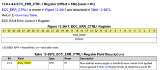

Hi Team,
1, What is the detailed meaning of ECC_RAW, how to calculate this address? I found the  ECC_RAW definition from the code in Jacinto, but need get confirmation on AM64x ECC_RAW calculuation.
-> ecc_row = 0x459 // row to inject the error, this should be the offset of the desired address from the start of the IRAM, divided by the stride of the memory
2, According to yellow words, "Inject only mode" is enabled by default,  the interconect ECC components software configure steps are listed here, but these steps can still be applied to ECC RAM, right?
