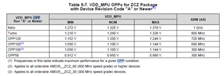

  • Hi Randolph,
    Thanks for your information. Please take a look of my patch on am33xx.dtsi.
    As you see, I commented out unnecessary voltage but only 600M HZ.
    So I expect the voltage of Vdd(mpu) should be about 1.17 to 1.22V. But the result is 1.35V.
    It seems like the voltage is still in Turbo Mode or Nitro Mode according to the value of voltage.
    Do you have any ideas?
    Also I have modified the am33xx.dtsi of u-boot-stage, the vdd of mpu still is 1.35V.
    If the frequency is 600M HZ, why Vdd(mpu) is 1.35V?

  • Hi Woody,
    Since RT doesn't enable cpufreq framework, I don't think the VDD will be automatically adjusted based on the CPU clk. I will have to review the kernel code to understand how to set the VDD voltage. I am currently working on a critical task, likely would need more time to get back to you. Please ping on this thread if I didn't respond by end of next week.

  • Hi Bin,
    I think the removal of opp table may not work, because I modify the opp table and reserve the opp50 only.
    	cpu0_opp_table: opp-table {
    		compatible = "operating-points-v2-ti-cpu";
    		syscon = <&scm_conf>;
    		 * The three following nodes are marked with opp-suspend
    		 * because the can not be enabled simultaneously on a
    		 * single SoC.
    		opp50-300000000 {
    			opp-hz = /bits/ 64 <300000000>;
    			opp-microvolt = <950000 931000 969000>;
    			opp-supported-hw = <0x06 0x0010>;
    			opp-suspend;
    make ARCH=arm CROSS_COMPILE=arm-none-linux-gnueabihf- am335x-evmsk.dtb
    then replace the dtb with mine.
    According to the datasheet, CPSW should not be supported. But the CPSW is still enabled.
    Does it mean the way you provided is not effective ?
