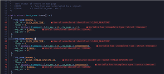

    Hello,Mr. Dannenberg.
    I also used "git checkout c2ca6740c240ccb9780868a52317b82f2a30fcc1" to obtain an older version of ltp-ddt, but I encountered an error during the compilation process.
    arm-arago-linux-gnueabi-gcc -std=gnu99 -g -O2 -g -O2 -fno-strict-aliasing -pipe -Wall -W -Wold-style-definition -D_FORTIFY_SOURCE=2 -I../../../../include -I../../../../include -I../../../../include/old/ -L../../../../lib clock_nanosleep01.c -lltp -lpthread -lrt -o clock_nanosleep01
    clock_nanosleep01.c:62:17: error: initializer element is not constant
    clock_nanosleep01.c:62:17: error: (near initialization for 'tcase[0].rq')
    clock_nanosleep01.c: In function 'do_test':
    clock_nanosleep01.c:100:9: warning: missing initializer
    clock_nanosleep01.c:100:9: warning: (near initialization for 'rm.tv_nsec')
    make[2]: *** [<builtin>: clock_nanosleep01] Error 1
    make[2]: Leaving directory '/home/zen/Documents/embedded/testsuite/ltp-testsuite/ltp-ddt/ltp-ddt/testcases/kernel/syscalls/clock_nanosleep'
    make[1]: *** [../../../include/mk/generic_trunk_target.inc:93: all] Error 2
    make[1]: Leaving directory '/home/zen/Documents/embedded/testsuite/ltp-testsuite/ltp-ddt/ltp-ddt/testcases/kernel/syscalls'
    make: *** [Makefile:133: testcases/kernel/syscalls-all] Error 2
    I check the ./testcases/kernel/syscalls/clock_nanosleep/clock_nanosleep01.c file
    I don't understand what is causing the error on line 62?

  • Looks like some header file is either missing, or not in the correct version (so it's missing elements that are needed). Usually `CLOCK_REALTIME` is defined in /usr/include/linux/time.h, so you could check your cross-compile sysroot if that definition is present, and/or perhaps why that specific header file isn't getting included.
    I'd recommend building this via Yocto, I'd think that would be easier as all thats needed is enabling/adding one package, and then all _should_ just work.
