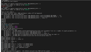

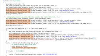

TDA4VM: Two video streams combine one CSI to TDA4. When TDA4 executes app_multi_cam Demo, the Frame Drop Count is accumulated
Part Number: TDA4VM
Camera 1 pixel is 1920*1080, data format is YUV4228bit, frame rate is 25fps;
Camera 2 pixel is 1280*720, data format is YUV4228bit, frame rate is 25fps.
The MIPI CSI is 4 Data lines at 1.5Ghz,
VISS , AEWB and Mosaic be bypassed
When TDA4 executes app_multi_cam Demo, the Frame Drop Count is accumulated, What is the cause and how to solve it
