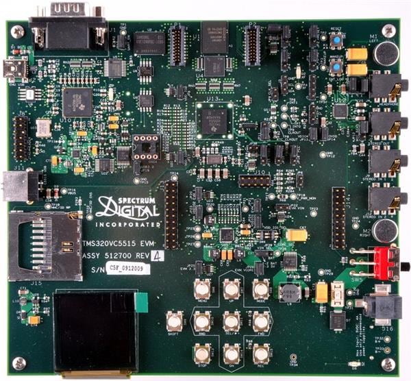

We are currently working on a DSP project using the TMDXEVM5515 evaluation board from Texas Instruments. This is our first time working with a DSP and with CCS12. Our goal is to make the EVM boot our custom program from the onboard NAND, NOR flash, SD-card or SPI-EEPROM whenever the device is powered up. We can verify that our program is working, when uploading via. the XDS100v3 Emulator.
The problem is that we can´t get the EVM5515 to boot from external memory, like NAND/NOR Flash or the SD-card.
So far, we've been able to generate a .bin file using hex55.exe with the following command:
C:\c5515>hex55.exe -boot -v5505 -serial8 -b -o .\bootimg1.bin .\CSL_GPIO_InputPinExample.out
Translating to Binary format...
".\CSL_GPIO_InputPinExample.out" ==> .text (BOOT LOAD)
".\CSL_GPIO_InputPinExample.out" ==> .cinit (BOOT LOAD)
".\CSL_GPIO_InputPinExample.out" ==> .const (BOOT LOAD)
".\CSL_GPIO_InputPinExample.out" ==> .switch (BOOT LOAD)
After the .bin file is generated, we have tried to burn it to the NOR, NAND Flash, SPI EEPROM and SD-card using programmer.out.
We can only verify that the .bin file is burned to the FAT32 SD-card, using a SD-card reader with a computer.
More over we have tried to run the cleaner.bin before and after a burning a program.
When we do a powercycle after a burn, we see no sign of boot loader or our program working. We also tried the onboard Reset button.
What could the problem be, why is the bootloader not booting from the .bin file on the SD-card or other external memory?

TMDXEVM5515 evaluation board:

  • Hello Ralph,
    Thank you for your prompt response and the insight into the limitations of the EVM5515 board and its associated DSP. As Samuel's co-worker, we both understand that it's an older model with minimal support at this point. We have looked into the boot document you suggested but are still experiencing some challenges.
    Given that the EVM5515 might not be the best fit for our ECG application, which requires a sampling rate of 2000 samples per second and capabilities like FIR filtering, could you recommend an alternative TI DSP chip? We're specifically looking for a chip that is not only more current but also has low power consumption requirements, as that is a critical factor for us. Additionally, compatibility with the ADS1298 A/D converter in our setup is essential.
    Any recommendations on this front would be greatly appreciated as we'd like to transition to a more supported and efficient platform for smoother development.
    EDIT:
    We just got the NAND Flash booting working!
    By using the old Legacy programmer.out from the EVM5515 CD.
    But the clock frequency is being divided by a factor of 8, it's possible that the clock is being scaled down to meet the Flash's timing requirements, and that might be our issue now.
